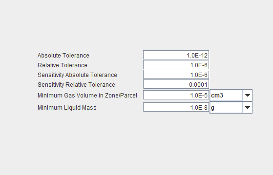

SubscriberHas anyone been successful in getting the Chemkin DI engine model to run with engine specifications that are different to the tutorial? When I have changed the engine specifications to match the engine I want to model, I repeatedly get the following error message.
Error: BAD AIR ZONE VARIABLE VALUE and Error: LOW AIR ZONE TEMPERATURE
Trying the suggested fixes does not seem to work. Any hints or ways to get it to work would be greatly appreciated!!

Ansys EmployeeHi:
Your question is a bit unclear as to exactly what changes were made to the setup, but the tutorial runs quite quickly as it is, so I am curious about the purpose of the changes? Most of the tutorials were created with older versions of Chemkin and so may not work optimally in newer versions where some of the numerics have changed.
Below are the current default settings for DI engine. If a project has been updated to a current version of Chemkin, these sometimes may work better than the original settings. The solver absolute tolerance can occasionally be increased to 1.0e-08 to allow convergence; this is still adequate to capture species concentrations.

SubscriberHi There,
I am trying to model a specific diesel engine and not the one used in the tutorial. When I have changed the engine specification to match that of the engine I want to model from the tutorial values I get the error messages shown in my original post. The tutorials run perfectly fine with the exisiting engine specification, but when I change the cylinder bore and stroke to that of a different engine it crashes, even with using the disel 1 component mechanism used in the tutorial. When I have changed the other engine parameters such as speed and compression ratio there has been no trouble, but when I want to use a different engine geometry there are these failures.Â
I always adjust the parcel gas volume to account for the change in the cylinder volume but this has not seemed to helped either.
