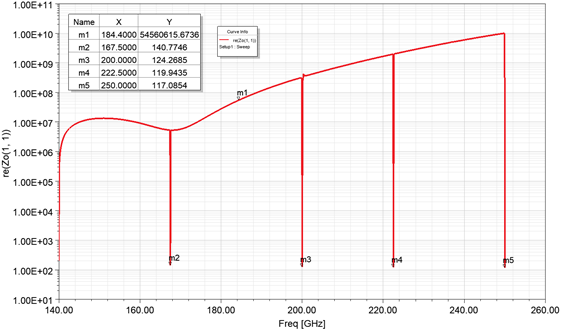

I try to simulate the characteristic impedance of a Si dielectric waveguide (Thickness x Width: 500um x 300 um) with wave ports.
- Ports were set to Zwave and "Do Not Renormalize"
- Port Zo(1,1) is supposed to be the characteristic impedance of the dielectric waveguide

May 7, 2021 at 12:49 amxuanding
SubscriberThe curve in the figure is not Z11. It is Port Zo(1, 1). When Wave port is matched, I think its port impedance should be the characteristic impedance of a uniformed waveguide.
May 7, 2021 at 12:53 amAndyJP
SubscriberThe result may be related to the wrong expectations about the fundamental mode.
Try defining a wave port with a mode (integration) vector. Or at least examine the field distribution carefully. These notches look like flips to higher order modes.
If results are still confusing, the dispersion and characteristic impedance problems are well analyzed by the eigenmode solver.
May 7, 2021 at 1:39 amxuanding
SubscriberThank you for the advice.
I have tried wave ports with integration lines, and it gives me the same curve, but without spikes. The E field distribution looks normal. Some similar tests were done in ADS (Advanced Design System) by exporting a S2P file, and the impedance for fundamental mode in a Si waveguide is around 120-150 ohms at that frequency range, which I think is a reasonable number.
For the eigenmode solver, I'm a little curious how to check the characteristic impedance. The quality factor and resonator frequency are defined in the results, but I haven't find other parameters. Could you please direct me how to test Z0, or share with me some related materials? Thank you again.
May 7, 2021 at 3:56 amAndyJP
Subscriber>have tried wave ports with integration lines, and it gives me the same curve, but without spikes.
100%, the spikes are higher order modes crossing the fundamental mode. With the field vector you lock the mode and filter them out.
So, the results should be correct for your model and setup.
For better understanding, you should make an eigenmode section of your waveguide, and sweep the phase in order to see the dispersion, which will give you a hint on impedance. If it is bent somewhere, that will be the answer.
Don't forget that when no boundaries of the model are defined for "airbox" in HFSS, PEC condition is used. You should define some radiation and move the boundaries far away.
May 11, 2021 at 11:26 pmxuanding
SubscriberHi Andy Thank you for the detailed instruction.
You are correct on the "spike" issue. I have updated my simulation setup.
I also tried eigenmode simulation. I'm able to obtain resonate frequency and dispersion, but have no clue to the characteristic impedance.
The characteristic impedance of microstrip line and metallic waveguide is able to extracted with drivenmodal collaborating with wave ports. And It was capable to simulate correct Z0 of dielectric waveguide using drivenmodal in HFSS 2019 R2 or older versions. However, I can't prove it now since our license doesn't support older versions due to "Electronic Pro, Premium, Enterprise product licensing". I think it is just data processing difference in 2020 R1, R2 and newer versions.

May 15, 2021 at 5:07 amxuanding
SubscriberThe problem is figured out.
In HFSS 2020 or newer version, the simulation configuration for waveguide impedance is a little different from the older versions.
Drivenmodal
Proper wave ports, do not renormalize
Port type: Zwave
Frequency sweep type: Discrete
Then port impedance Zo(1,1) would be the waveguide impedance.
