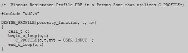

      In the manuel, I found this UDF to define a viscous resistance profile in a porous zone.
      I want to define the coefficients in each direction and as function of time. How can I define this parameters in the UDF?
      Have anyone any UDF-Code to change the coefficients as function of time?
      Maxime
      You've found the DEFINE_PROFILE example, now look in the UDF Manual for a time dependent UDF and combine the two. As a hint, the macro for the current solution time is    RP_Get_Real("flow-time")

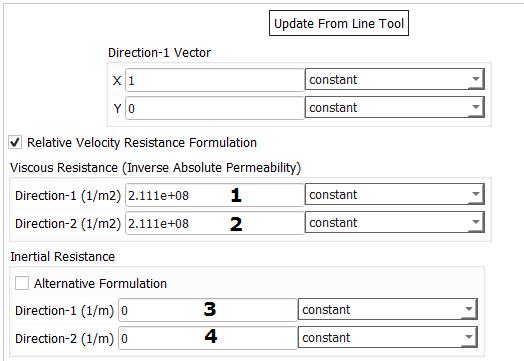

      In this UDF, there is just one parameter "a". How do I know what this term means? In addition, this function induces an isotropic porous media.
      By a 2D-Case for exemple, there can be up to 4 different terms.
      Should I juste use "F_PROFILE(c, t, i)" to define the parameter?

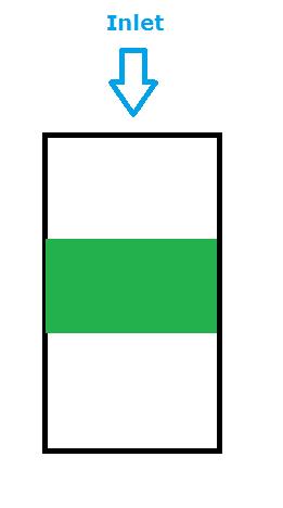

      I want to modell the closing of a valve using a porous media like the exemple below.

      You can use the same udf for each field. Any you need it at cell level that is why C_PROFILE. In a testing DEFINE_PROFILE Just print "i" to know which integer will be reported and based on that you can then create a single dEFINE_PROFILE for each hook at "i" position.

      Sorry but I don´t understand what you mean. How can I define in a UDF each of the 4 coefficients?
      Moreoever, I don´t understand why a DEFINE_PROFILE is needed for this kind of UDF.

      In define profile call there the integer "i". This will get a value based on the fueld you want to hook the macro. Saying That if you print for a test that integer you can then easily know the values of all places it fields.
      Why DEFINE PROFILE: Why not?

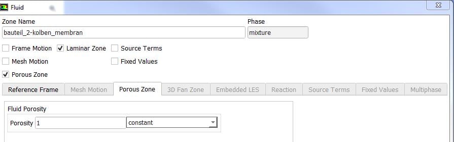

      By using a multiphase flow, we can just change the value of the Porosity:
      May I use the same UDF with DEFINE_PROFILE that utilises C_PROFILE?
      Maxime

      Porosity in the last post is the amount of "solid" in the fluid region. It's used for heat transfer and is not related to the resistance coefficients.
      If you need the porosity to vary in each direction, then yes you'll need a section of UDF for each direction. The "porosity_function" is the label for that profile, just repeat the whole DEFINE_PROFILE part (with a different name) for each value you need/want.
      You can use a C_PROFILE but I don't think you need it as the whole porous region changes at the same rate (based on what you've said so far).

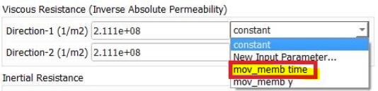

      For a single phase flow, I can use the UDF following UDF.
      The parameter "a" in the UDF defines for exemple the viscous resistance in the direction-1 if I hook the UDF as follow.
      It´s better to use then F_PROFILE instead of C_PROFILE ?

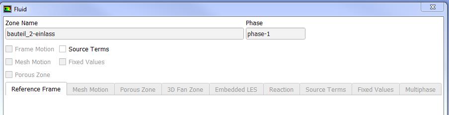

      I have then define the both phases (water liquid and water vapor) and the interactions. By defining the phases, I have seen the parameter "Diameter". What is this parameter?
      The definition of "porous zone" is always grayed out for each phase.
      Maxime
      Turn on the Porous Media under Mixture, and then go to each Phase to set the coefficients. It's intended to stop you setting a model where only one phase sees a porous zone.
