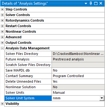

Whenever I create a Command Object that includes an input parameter that has units, I use the Analysis Setting to set the Solver Unit System to Manual and set the Unit to what I want. That way the Unit setting in Mechanical doesn’t change what the solver does.
