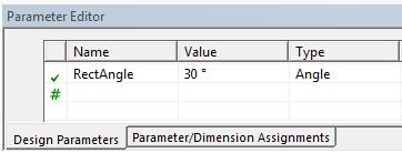

SubscriberI would like to have a parameter change the angle of the rectangle on Design Modeler (ANSYS 17). I was also planning on extruding it.

SubscriberI figured it out now! I created a new plane where I rotated the angle of the plane about the z axis. But I do have a follow up question. I am trying to cut off the corner volume of the rectangular extrude sticking out from the counterbore sector:
It should be noted that I sketched and extruded the rectangle after slicing and suppressing the remaining sector bodies, and the rectangular body was placed directly on the bottom of the sector. I tried Boolean operations where I used the sector portions cut off from the second third and fourth quadrants of the X-Y Planes as the 'tool bodies' and the rectangle as the 'target and only ended up with the full rectangular prism
