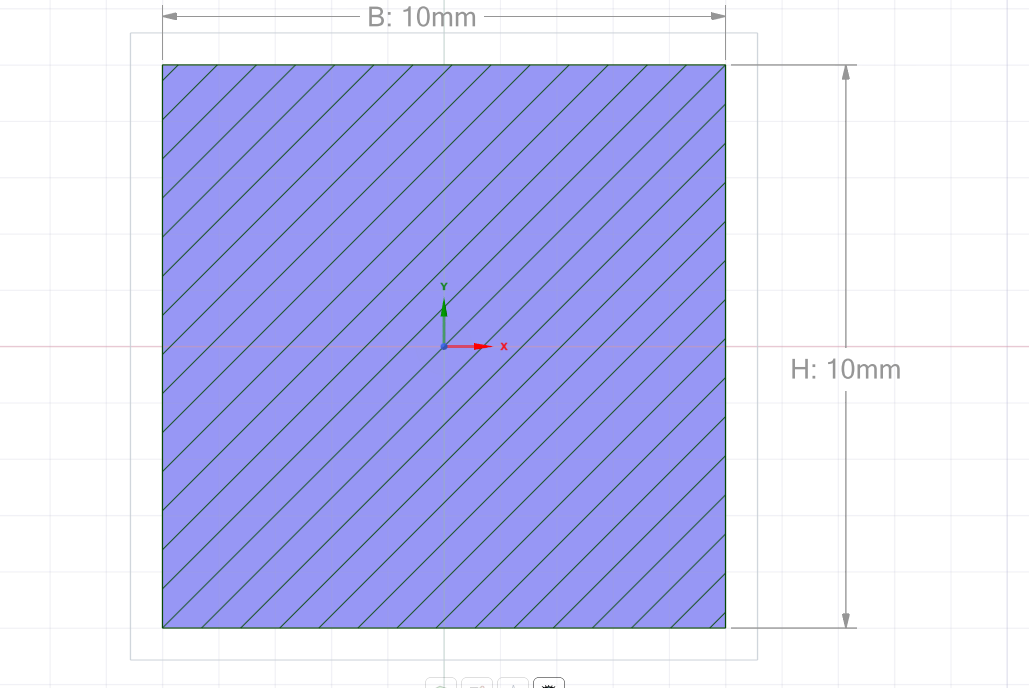

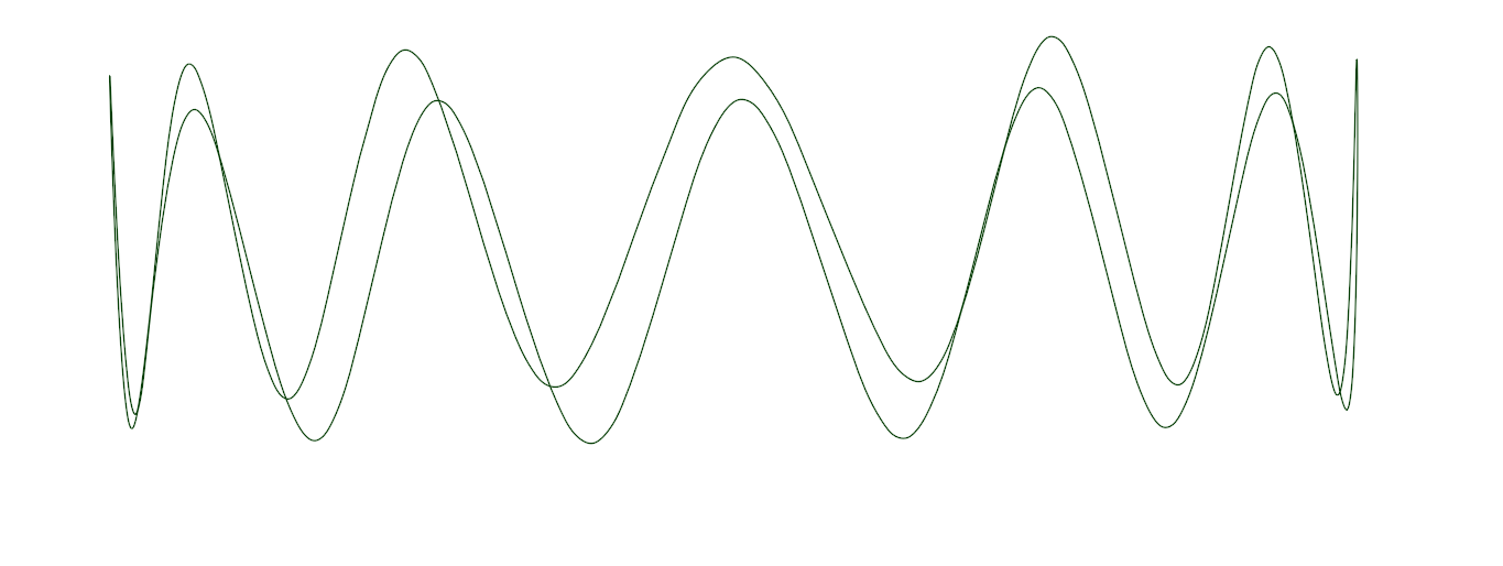

The photo 1 show my model. It's a wired stent model in 3D. So i need to create a cross section for this wired model. But the problem is the coordinate system of the cross section is the original system (photo 2). And i need the coordinate system of the cross section is the cylinder coordinate system of the stent. If not the form of the stent is very weird and not right.
Can someone help me to solve this problem? Thank you all and have a good day
