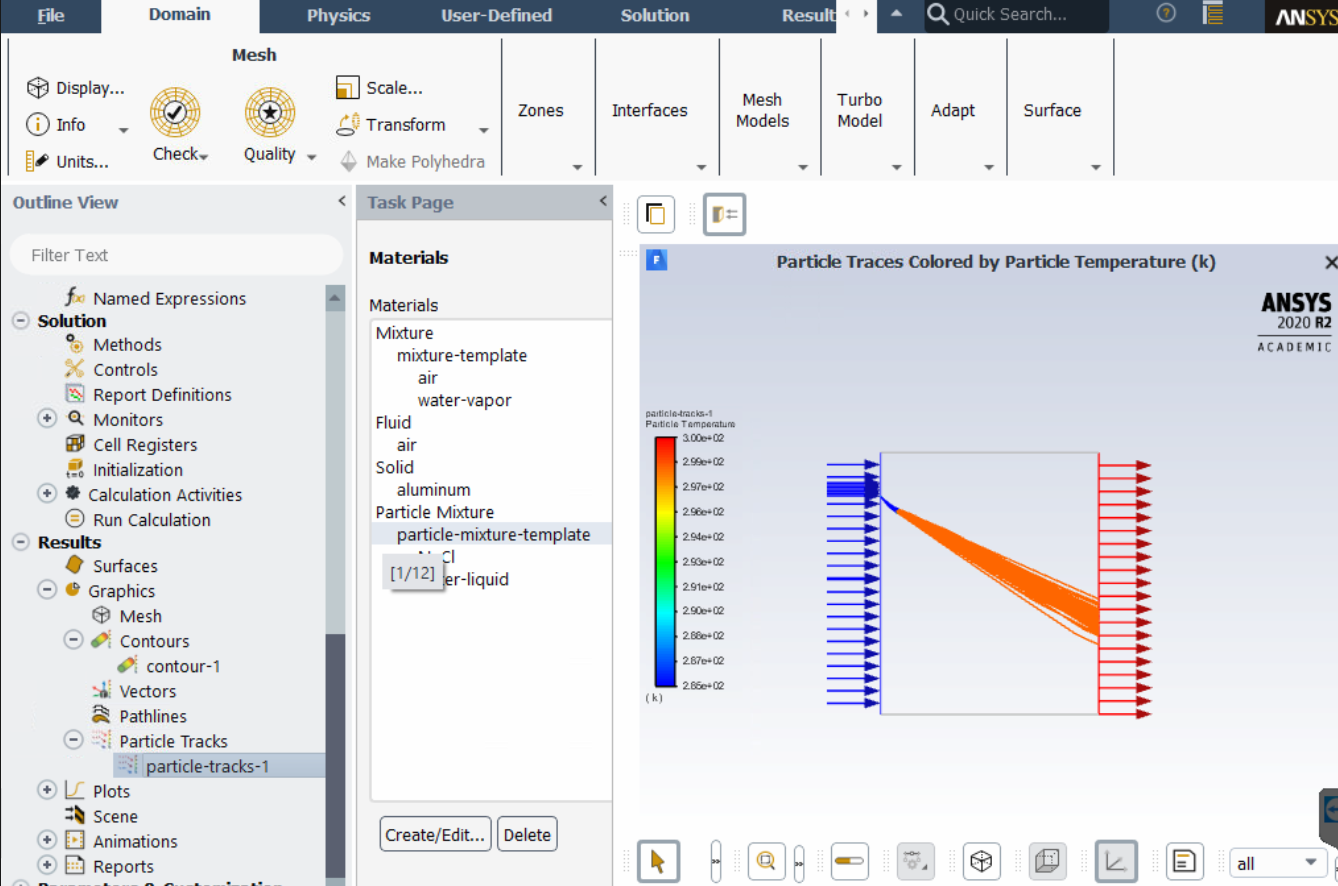

I use the Ansys 2020R2 student version. After I get results in Fluent, I open the CFD-post and couldn't load the results. The view window is black (CFD-post has been linked to Fluent). I post the fluent window and CFD-post window below for your convenience.
Anyone know how to solve it?
Thanks!
Result in Fluent window:
September 2, 2020 at 6:51 amKeyur Kanade
Ansys EmployeeCan you please check if you can open stand alone CFD-Post i.e. outside WB and read Fluent files. If it still gives issue then it may be installation issue. Also please search on forum, there are many posts on black graphics window of CFD-Post. nAlso from image it looks like you are having particle tracks. You will need to export it from Fluent to CFD-Post. Please check File --> Export. Please see help manual for more details about these commands. nAlso please check if you can post process in Fluent itself. You can go through nRegards,nKeyurnGuidelines for Posting on Ansys Learning ForumnHow to access ANSYS help linksnnViewing 1 reply thread- The topic ‘CFD-post issue’ is closed to new replies.
