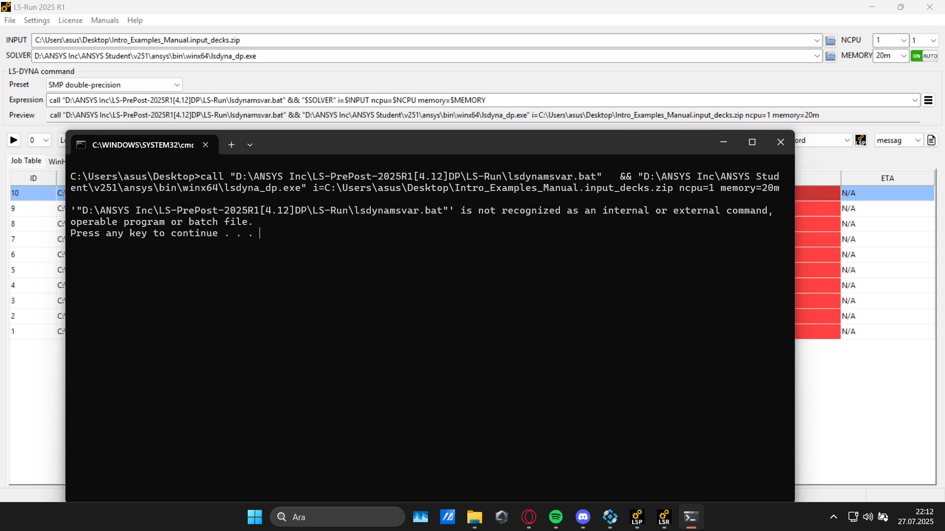

      Hello everyone.
      I'm trying to learn LS-Dyna. I've made the arrangements for my first simulation but when I launch the LS-Dyna and click on run the simulation I always get the terminated message. I've opened the command prompt window to see what's wrong and it seems to be a problem with a thing called lsdynamsvar.bat. I've checked the .bat file's path and the file isn't there. Apparently that .bat file is missing entirely how can I fix this ?????
    • Dennis Chen
      Hello, go ahead and use the following command in place of what you have.   basically you don't need that bat file although you can use it to set local environment variables
      In the first line above, just type in below.   You will want to add more parameters such as -s or case or others to further parameterize the job submission but below is the minimum you need.
      $SOLVER i=$INPUT ncpu=$NCPU memory=$MEMORY
