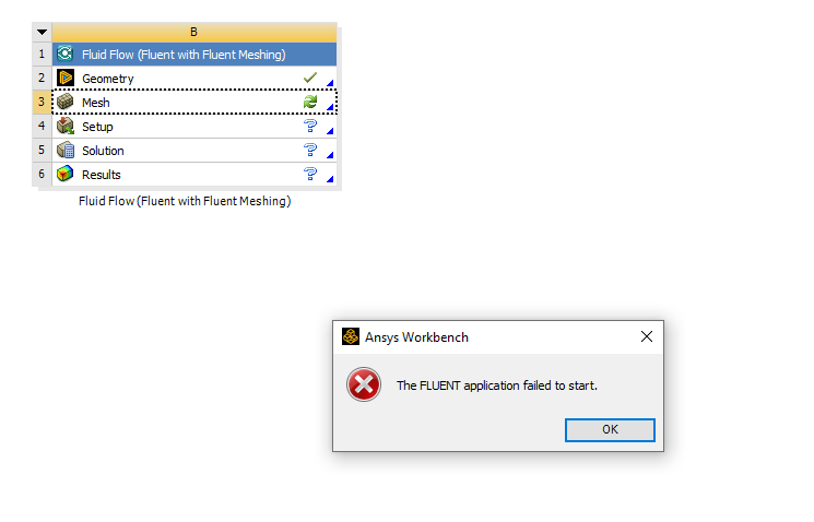

      I've just installed Ansys Student (2024) so I can use Space Claim and Fluent. I have no issues opening and using Space Claim but Fluent doesn't open at all.
      I initially had an old install of Ansys 2021 which I have now fully removed (Fluent 2021 worked fine), and I also uninstalled and reinstalled 2024 in hopes it would fix the issue but it didn't.
      None of these work:
      Open Fluent through space claim
      Open directly from the program files
      Trying to open after allowing all ANSYS programs through the firewall or turning off my firewall entirely
      Updated graphics drivers
      Not even a window opens or an error message. I only get an error message saying 'FLUENT application failed to start' if I try to open it through workbench but no other information.

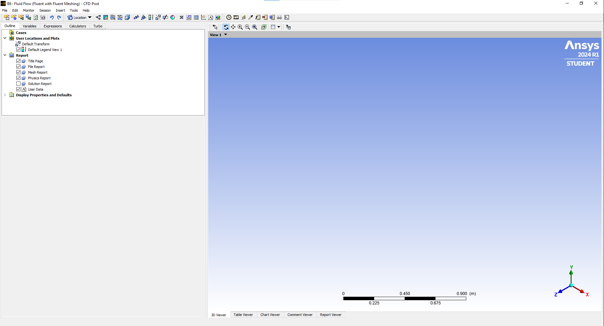

      When opening through workbench by clicking 'mesh'  or 'solution' this comes up:
      However when I click results it opens:
      If I try to open it through the start menu and finding fluent or opening through spaceclaim then nothing happens at all.
