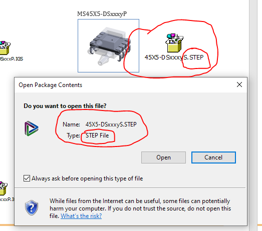

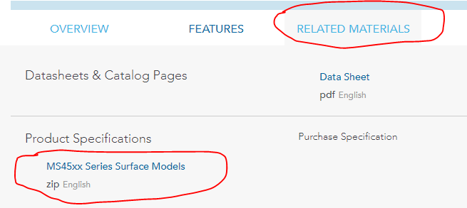

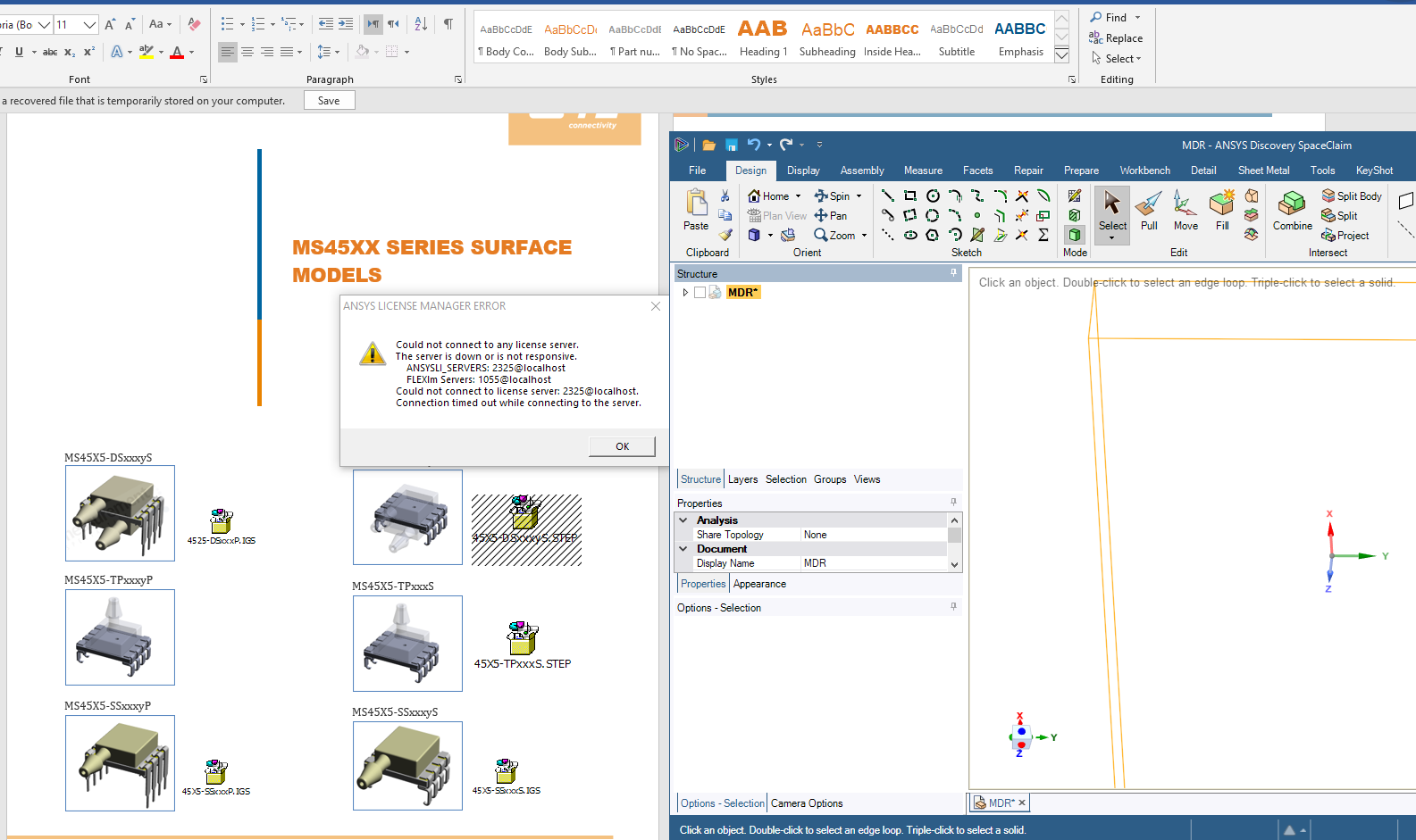

For reasons I do not understand TE Connectivity provides CAD models of their files embedded in MS Word docx OLE (objects). I have ANSYS Discovery Live subscription/perpetual license instillation but when I try to open the CAD models from the OLE links within the MS Word Document I get a license error.  I did not think I use a sever license setup so I am unclear why the license error is popping up. I have all my CAD files i.e. stp, step, igs etc... all associated with ANSYS Discovery Live/SpaceClaim. I do not see an obvious way to save the CAD files from the word document to a folder to just directly open it with SpaceClaim "after download" from the OLE.ÂI have asked TE for the CAD files directly but it is taking some time and it would be nice for me not to have to do that every time I need to access their files.Â
Any help would be appreciated.Â

I am unsure that OLE is a file format? OLE = Object Linking and Embedded which I thought basically means the "object", in this case the STEP files and/or IGES files, are embedded in the MS Word Document. ANSYS/SpaceClaim recognizes the files as STEP or IGES but appears to be trying to validate my license via the license sever manager (screen shot from first post) before opening the file. I dont think this is correct because I am not running a license server. I run in standalone/subscription mode.Â

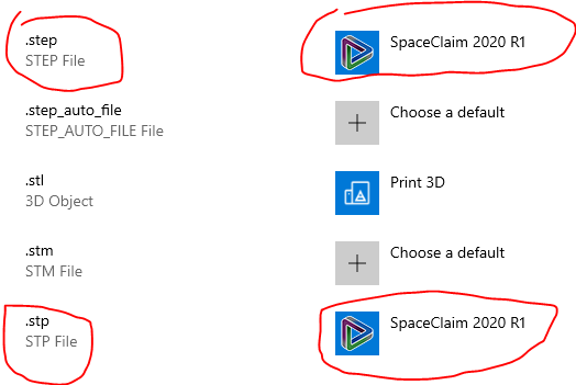

I mentioned that I had already set SpaceClaim as the default app in my earlier post. You can see that my icon is showing the ANSYS/SpaceClaim icon indicating that it was/is selected as the default app.

I had to change a *.STP file i had to actually be .step and when double clicked it it asked what program and i navigated prgroam filesansysv201scdm and picked the same exe i load SC with.
If you load the same Spaceclaim.exe do get the server error?
What if you doubleclick an scdoc?
Do you have multiple SpaceClaims installed?

The default installation/shortcut has the link ""F:Program FilesANSYS Incv201SCDMSpaceClaim.exe" /UseLicenseMode=true" in the shortcut properties. This is the one that I use and this is the one that I linked to the default stp/step files. It works fine on normal shortcut execution but returns the license error when I try to open the OLE object.Â
