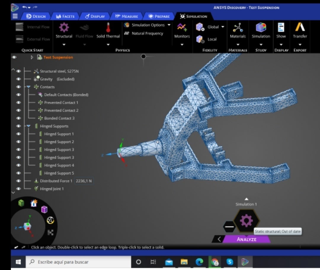

SubscriberHi everyone! I've got an issue in Discovery 2.5, I was doing the tutorials and after setting all simulation conditions in the Analyze Stage and then clicking in the green button to start the simulation, Discovery shows me the mesh (that's OK) but after finishing the calculations, it doesn't show the results.
Just like in the image attached, it asks me to update results, I update them but the problem still persists.
What could be the cause?

Ansys EmployeeHello JaegerW
One user reported this issue for a fluids case but when he changed one of the boundary condition values, the issue got resolved.
In this case, the status of the static structural simulation is showing as out-of-date. So I wonder if there is any simulation and results data available for viewing. Can you try changing the value of force and see if it solves and displays the results? If not, can you open one of the inbuilt sample problem (like the bracket example) and try solving it and see if you can view the results?

SubscriberHi, Naresh! Thanks for the answer.
I tried with the bracket example, it works OK in the Explore stage but in the Analyze stage I'm still having the same issue, I click in solve and then I can only view the mesh, the results aren't plotted, it asks me to solve again in order to update the model.
I attach some images showing what i said.

Naresh Patre
Ansys EmployeeThe news is that there are no workarounds for the GeForce GTX1050 Ti card as it is not supported hardware.
