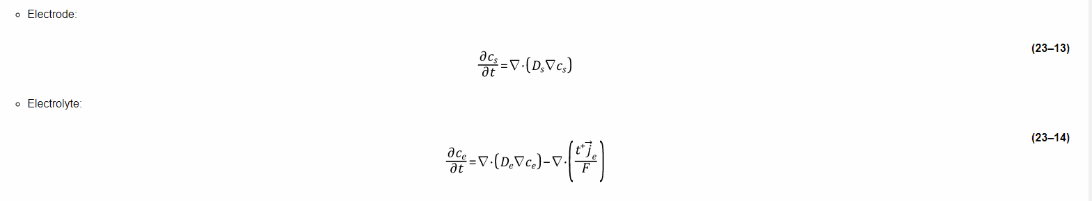

I'm using Fluent-Lithium-ion Battery Modelling. Based on the theory guide "23.2.2. Lithium-ion Battery Model Theory", both C_s and C_e are solved.

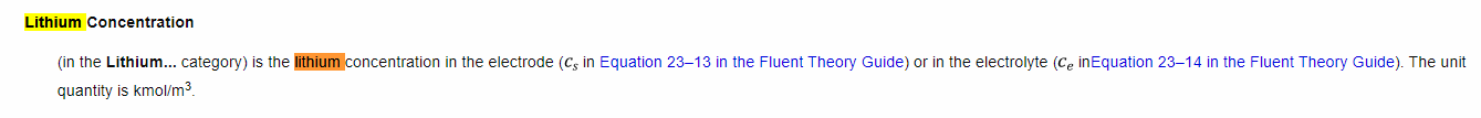

Ansys EmployeeHi, nThe Lithium Concentration post-processing variable stores the solid and electrolyte Lithium Ion Concentration. This is confirmed in section 42.4 of documentation as pasted below. Also, I checked on a case and can confirm this. So, to plot the Lithium Ion Concentration only for the electrolyte, simply display Lithium Concentration on the electrotype cell zone. Hope this helps.nn
