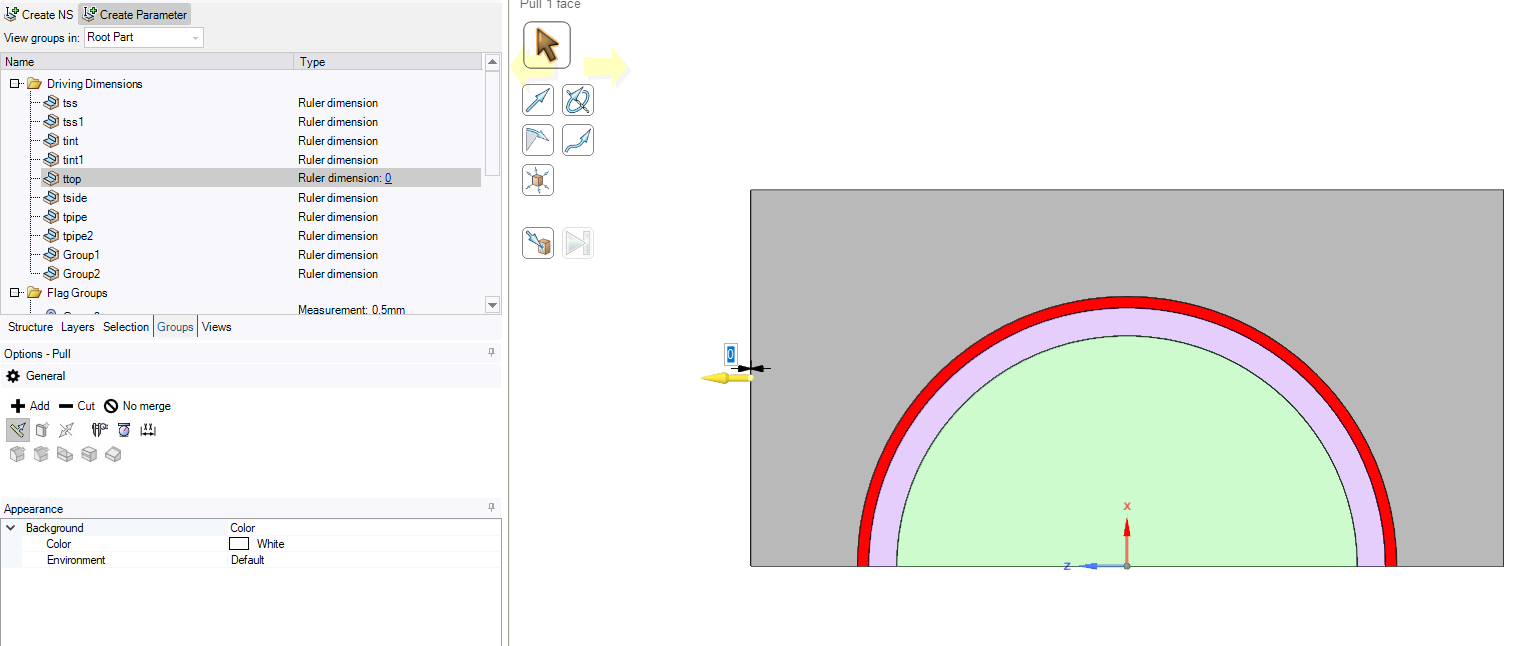

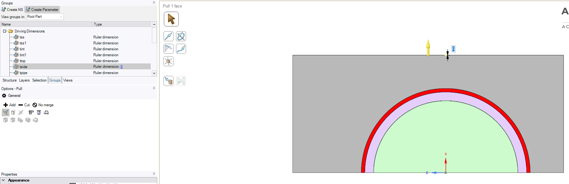

    • thospe
      In the attached images, I have one variable, "tside", shown for two different cases (Figs. 1 and 2), as well as "ttop" (Fig. 3) and "tss" (Figs. 4 and 5). There is an additional set of variables that are adjusted together with tss in such a way that the geometry remains properly continuous and the red region has a constant thickness of 0.2 mm.
      Each of these is associated with a pull command. I have a fluid flowing through the center (green) in the y-direction (into the screen) and a heat flux on the surface in the positive z-direction (left). In particular, I am interested in the maximum temperature of the red region.
      If I take two design points, changing tside from 0 to 1 mm (comparing the cases from Figs. 1 and 2), highlight them both, right-click, and "update selected design points", I get 827.364 K in both cases (other output variables report exactly the same results as well). If I manually reload the mesh and run directly in fluent, I get 827.36 K and 817.59 K, respectively.
      On further review, it seems that my issue is nearly identical to this one here: /forum/discussion/7134/doe-parametric-optimization-solution-is-different-than-fluent-stand-alone
      Like both Flow and Antoinel, I am getting very different results when using the design point interface vs. opening fluent and running from there. Flow claimed the problem went away with the R12020 version, but that is what I'm using. I don't think automatic case modification can help me, as the variables that are causing problems aren't really internal to Fluent, but instead should modify the geometry that is sent to the fluent mesher.
      There doesn't seem to be an obvious pattern to this - sometimes it correctly updates the geometry, sometimes it does not. This can happen with any of my geometric variables; tside and ttop do not give me the error message, I suspect because if one of the radial pull variables (like tss) fails it can result in overlapping geometry or a gap.
      Here are five cases (the arrow corresponds to the boldened variable):
      ttop=0, tside =0, tss=4.6 mm
      ttop=0, tside=1 mm,tss-4.6 mm
      ttop=0, tside=0, tss=4.6 mm
      ttop=0, tside=0, tss=5.1 mm

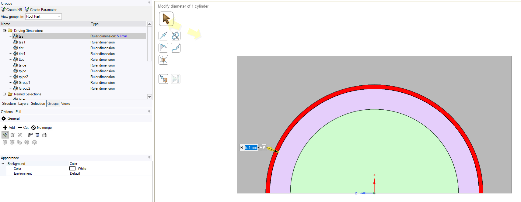

    • thospe
      I think I have found the problem, though I'm not sure how to solve it. I redid the whole thing from scratch, and instead of pull commands, I used move commands centered around the y-axis and driven by the radius of the semi-circular edges. This is definitely a much cleaner way of doing it, but doesn't solve the problem.
      I have found that the problem is that it does not update these dimensions simultaneously, but instead does so in sequence. For example, suppose I increase the inner pipe diameter by 1 mm while moving the other surfaces to keep the layer thicknesses fixed. If the inner radius of the red region is updated first, it will move past the outer radius, which breaks the geometry even if the final result should be a sensible configuration.
      Is there a workaround for this? It seems I need a way to ignore the connectivity while moving the surfaces, then redraw the connections between them once everything is in the correct place.
      Edit: I think I have come to a solution by using dimensional annotations to drive the changes - it also didn't occur to me that I could have one move command that moves all the surfaces to accommodate the innermost diameter, another command that moves all but the innermost surface to accommodate the pink region thickness, etc. Will follow-up if this works.
