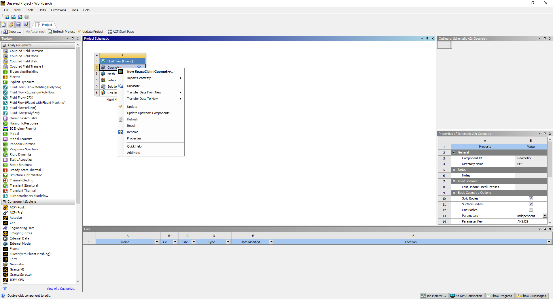

      But, no matter it's student or research, I should be able to use Design Modeler for geometry, right?
      In theory yes. Can you check your licence for "agppi" and also screen grab so I can see what you've got. Add a new Geometry task, and right click to see what editors are available.
    • I-Lun Chen
      It's like below, when I right click geometry, only SpaceClaim pops up.
      Mystery solved. You need a patch to get DM working. You'll need to download that from the Customer Portal.

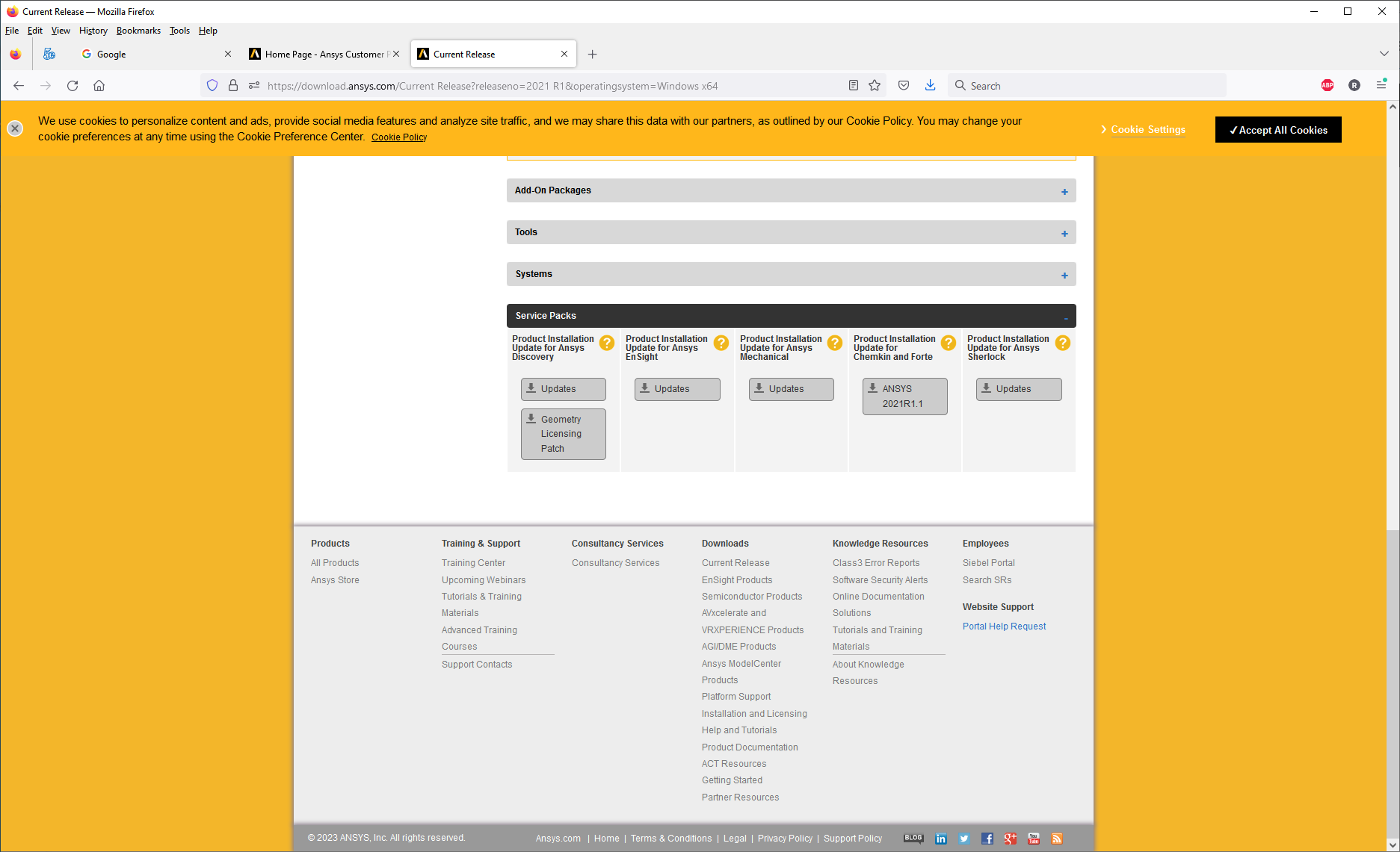

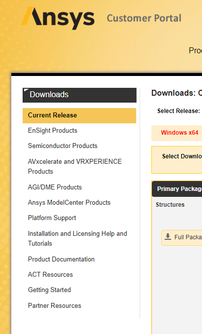

      Hi, where can I download it in the customer portal?
      It's in 2021Rx Service Packs, so yes.
    • I-Lun Chen

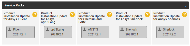

      Do you mean this? But I don't see DesignModeler...
    • I-Lun Chen
      But aren't those for discovery?
      I was told they were more general. Did it work?
    • I-Lun Chen
      It only includes the Discovery, which we do not have license for.
      Does it require a license to access DesignModeler?
