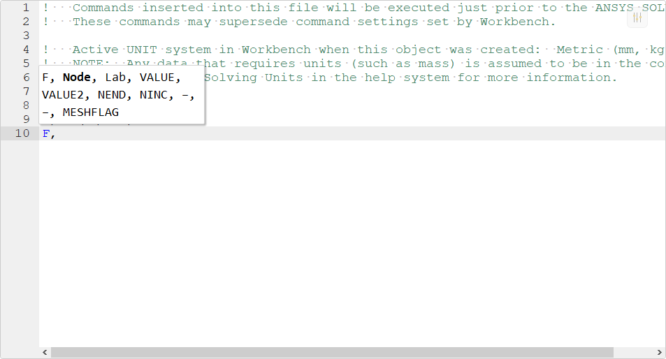

Ansys EmployeeKey Points in APDL are not Nodes. They are the geometrical equivalent of a node, but they are just a point and do nothing related to the FEA analysis. You cannot apply a force to them. You should create a node and apply the force to the node. You will need to also attach the node to some element(s) for the force to have any meaningful use.
April 16, 2023 at 7:26 am
Paula Alonso
SubscriberThanks!
And if I have to compare distances between points, can I use in that case keypoints? The program I'm trying to do is compare the distances of some nodes and a reference point (outside the mesh) and the one that it's closer to it apply the force in that node.
Thanks again!
