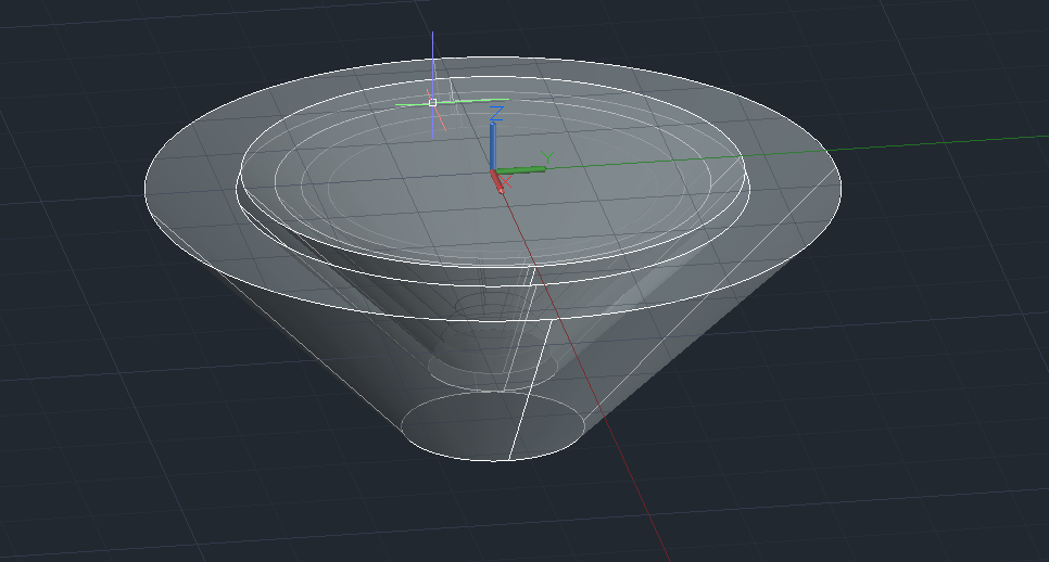

SubscriberI have an extremely simple model of a cone rotating inside another bigger cone. The problem is the only shapes I can assign a motion band to, are either cubic or cylindrical. it wont accept a Conic shape.

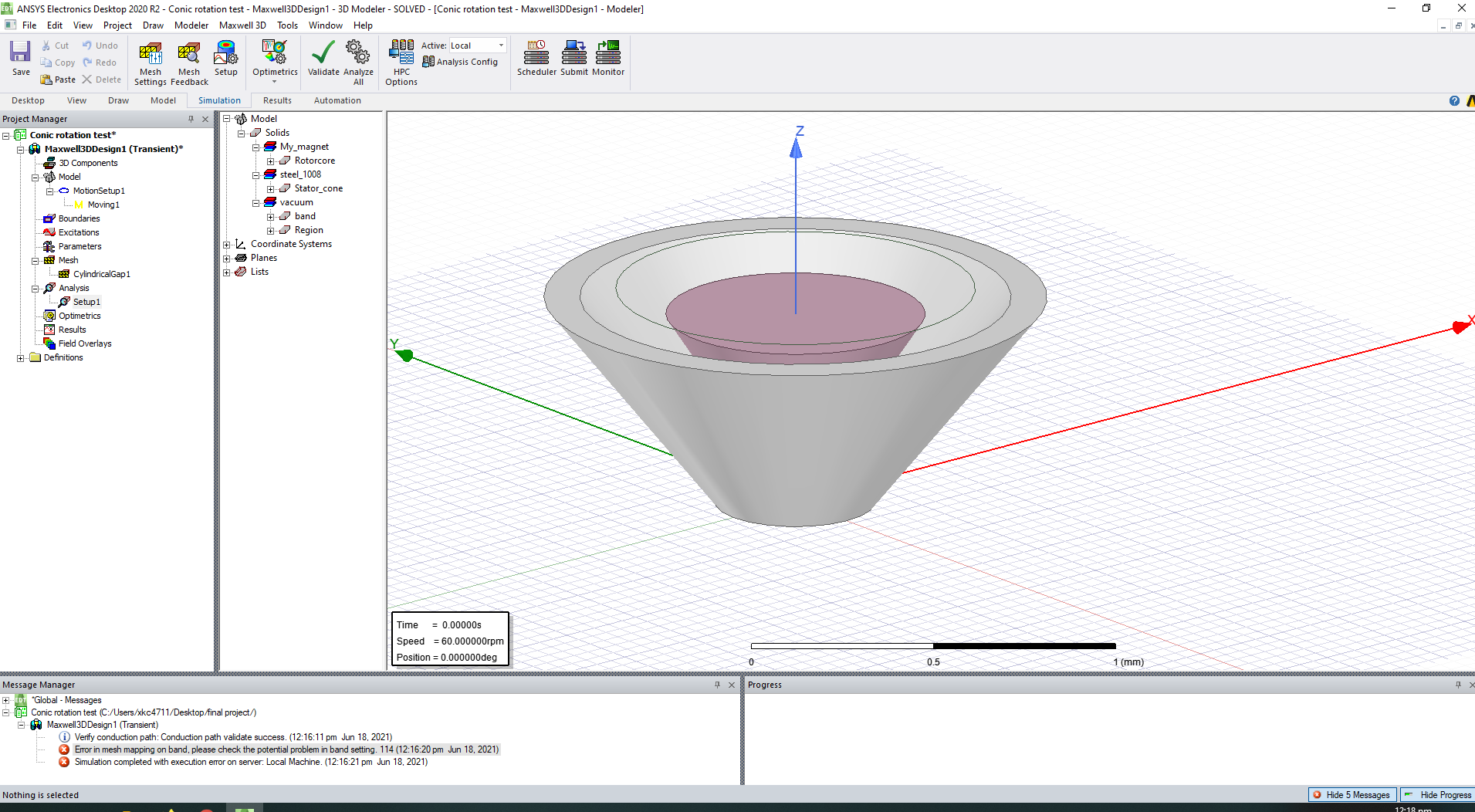

"Error in mesh mapping on band, please check the potential problem in band setting.'
when I change the band shape to a cylinder and encapsulate all the objects, the simulation works. Also if I remove the outer cone and just put a cylinder band around the inner cone, again the simulation works fine.
Please help

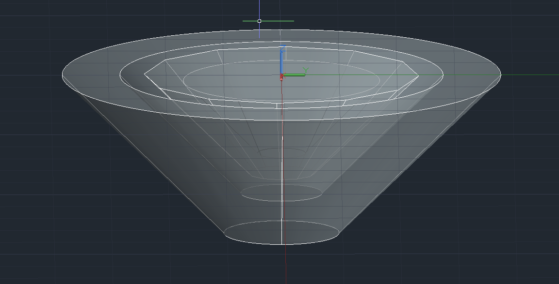

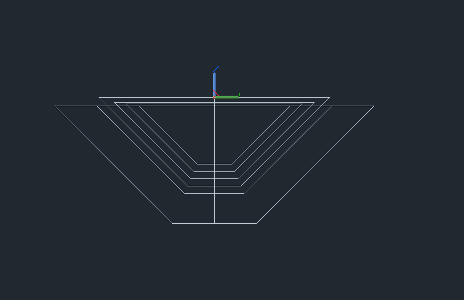

Create two more dummy cones one between the band and inner core and the other between the band and the outer core.
If this didn't work. Create the band shape in a CAD tool with segments(this might be difficult to do in Maxwell directly) and then import and assign it as a band.

I think I have done what you have suggested to put the extra dummy cones in, unfortunately I get the same error.

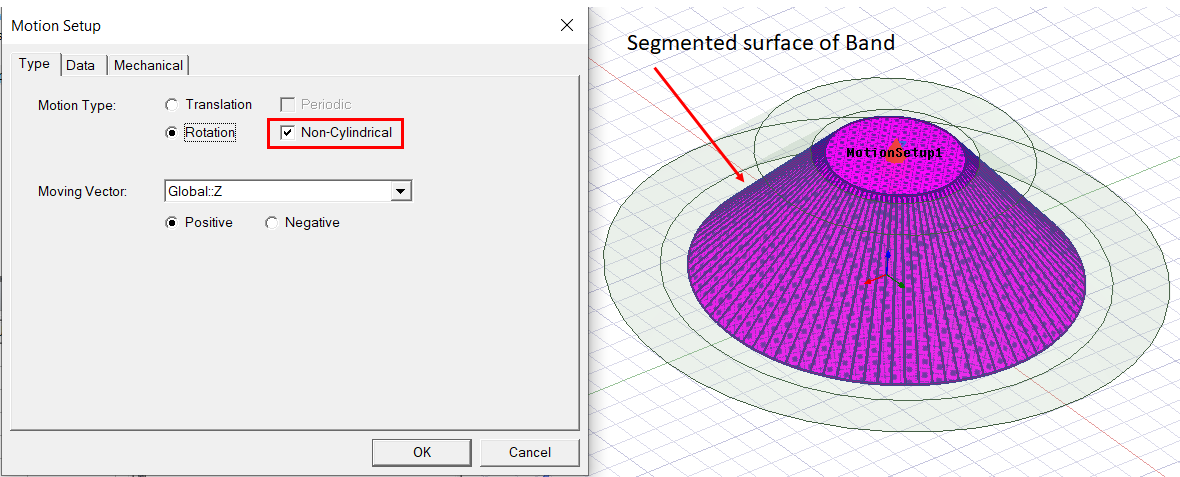

I then created a 12 sided pyramid or 'segmented cone' as the band. Run the simulation and I get the same error with the additional warning "Specified band is not a rotational object, unable to do band mesh. Will do regular mesh instead".

screenshots show the extra dummy cones made in CAD and the segmented band
