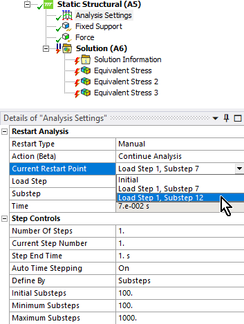

SubscriberIn nonlinear solution sequence with multiple substeps, you can pause during the solution process after a converged substep and look at some results, then continue the analysis from the last converged substep. You must make an edit under Analysis Settings to tell it to continue from the last substep, otherwise it will start again from 0.
If you save your Workbench project before you turn off the computer, after you paused the solution, you can continue the solution after you turn on your computer.
After the solution has finished, you should save the project and you can open the results after turning off the computer.

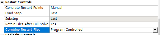

After the solution is completed, can you continue from the point of completion?
For example, after the transient analysis is completed with 10 steps, the total number of steps is increased to 15, so can we continue from the 10th step?
January 26, 2022 at 10:36 ampeteroznewman

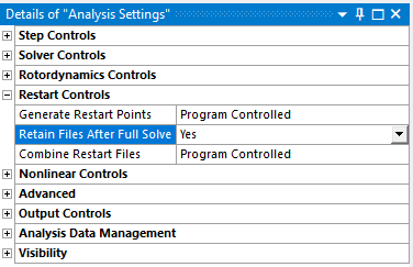

SubscriberYou have to set Retain Files After Full Solve to Yes before the solve finishes.
Then you can add another step and change the loads in that new step. If you simulated 10 seconds in 10 steps, and want to change the End TIme to 15 seconds, you don't need 5 more steps to do that, you can set the End Time for Step 11 at 15 seconds.

SubscriberSet Retain Files After Full Solve to Yes.
Let's say you have a Force load and two load steps defined. Step 2 ends at 2 seconds. The Tabular data for the force shows step 1 is 1 lbf, step 2 is 2 lbf.
You solve, it completes the two steps and the end time is at 2 seconds.
You can add Step 3, End Time is 3 seconds.
Edit the Force load and in the tabular data, on the last row at 3 seconds, type 3 lbs.
Use this pull down under Analysis Settings to select Load Step 2 as the restart point.
Hit the Solve button. It will start at the end of Step 2 and compute Step 3.
