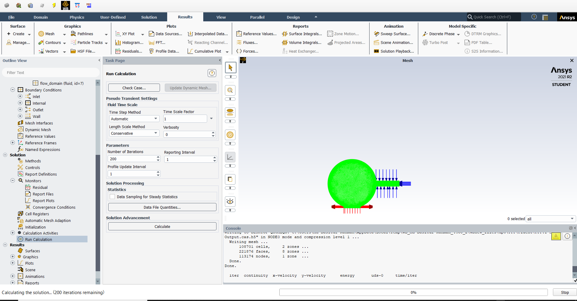

After clicking the Run Calculation Button, I am not able to see the running iterations. As you can see in the attached photo, my calculation is running, but there are no scaled residuals showing up. Thus I can not check if my solution has converged or not! Anyone else having this problem?
Thanks.
September 30, 2021 at 10:57 amRob
Forum ModeratorFluent has triggered the run, but looks to have not completed the first iteration so there isn't anything to display. How long has it been stuck for?
September 30, 2021 at 11:02 amaerorocker
SubscriberIt is stuck for nearly 15 mins. However, during some previous calculations, the scaled residuals also did not show up even after the calculation was done. it showed that the 'calculation is complete' but showed no scaled residuals. just the geometry. Also, there is no indication of how many iterations have been done so far. it goes straight to calculation complete and that's it. I forgot to mention it in the original post sorry (: .

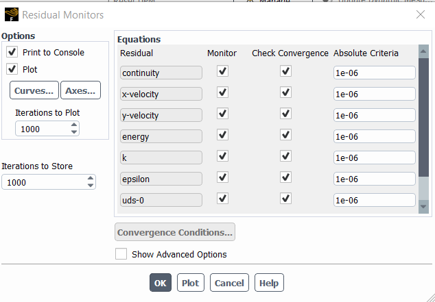

September 30, 2021 at 1:49 pmRob
Forum ModeratorCan you open the Monitors panel and post an image? I wonder if you turned something off by accident.
September 30, 2021 at 1:54 pmSeptember 30, 2021 at 2:40 pmRob
Forum ModeratorWeird. I'd expect that to plot.
