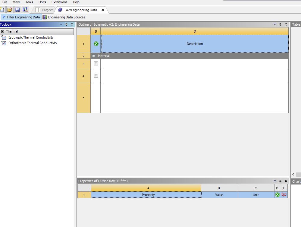

Can not find the column for adding the name of new material in Engineering Data window

      Try:
      View>Reset Workspace
      and
      View>Reset Windows Layout
    • Tareq044
      Actually i tried it several times but nothing changes and i also re-installed the software but still it is remaining like . To be honest i did a foul job , i crossed the the table when i was first in this window, now i can not restore that .
    • Aniket Chavan
      You can try resetting ANSYS configuration by renaming the %appdata%Ansys  folder to anything else.
