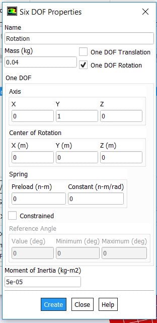

SubscriberHello,
I am trying to simulate the behaviour of a vertical axis wind turbine in fluent (v19.2). In order to do this, I have created a rotating mech around the turbine. At this stage, it is possible to apply a rotation speed but I would like to know if there is any function enabling the free rotation of the turbine, as the aim of the study is to determine at which speed it can rotate.
Thank you in advance for any advice.

SubscriberHi,
you can use the option 6DOF, it allows the part to move thanks to the fluid forces.

Ansys EmployeeThanks Maxime!
Good to see you pitching in. We encourage you to continue on this.
Yes, you will need to use 6dof.

greg018
SubscriberHello again,
I have followed the tutorial indicated by Max4. I have just one issue and it disable the solving process. In "Dynamic mesh", "Six DOF properties", I entered a mass of 0.05kg and an inertia of 5e-5 (obtained via SolidWorks). The problem is that the program automatically set the value of the mass to 0 when I close the window. I have tried "5e-2" instead but the result remain the same...
Is there any solution?
Thank you.
Greg
December 26, 2018 at 2:34 pm
peteroznewman
SubscriberGreg,
If the object only rotates, and doesn't translate, there is no need for the mass, the Moment of Inertia is all that is needed for the dynamics equations.
