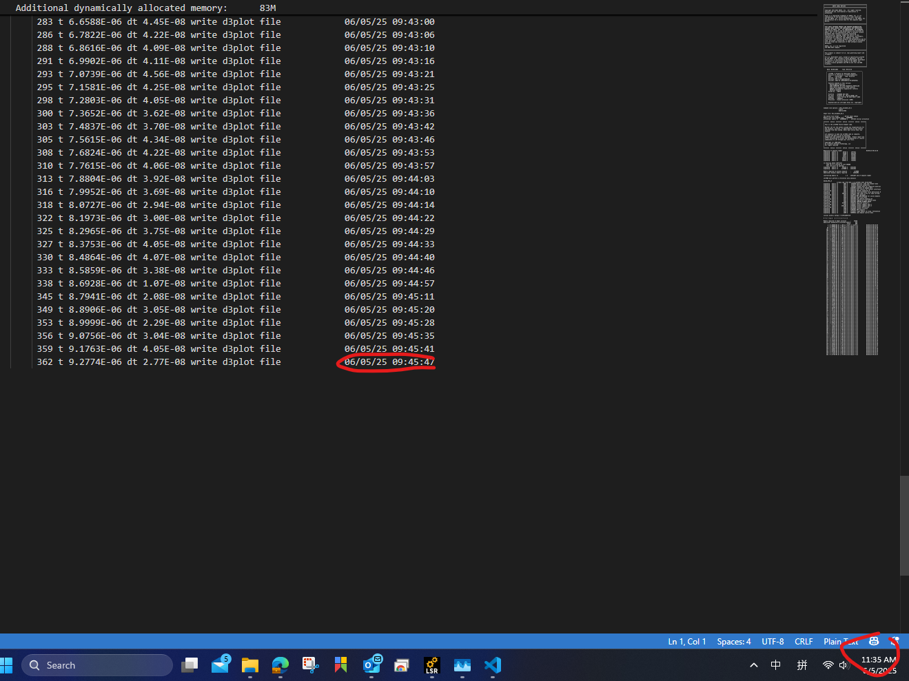

call lsdyna_dp.exe to run .k file but no further output generated
    • rji229
      In my previous post, it was suggested to use the LS-DYNA command lines directly in your Python script to call the solver and run the .k file. (Location of results when using python or cmd to call ls-run to calculate k files). However, this method doesn't work when I have multiple ANSYS versions on my desktop. So, I need to load "C:\Program Files\ANSYS Inc\v251\ansys\bin\winx64\lsprepost412\LS-Run\lsdynamsvar.bat" and then run "C:\Program Files\ANSYS Inc\v251\ansys\bin\winx64\lsdyna_dp.exe" through "cmd". But the issue is that some cases will be stuck, but they can be run manually by ls-run. Is there any solution for this?
