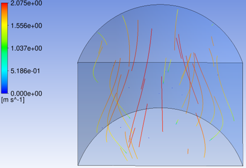

      Hi-I am using randomize injection option to inject DPM particles from the inlet of a pipe. Different particle tracks are going in different directions in an unsteady sim. How can i find out the initial injection location of particular particle track on the inlet so that I can detect which initial injection location is causing what deflection? I have exported particle tracks into CFDPost as Fluent does not show tracks for unsteady simulation but cannot get the initial position of each track. thanks.

      I mean when i export the particle history data to CFDPost and import as .xml then I can see tracks (continous lines) for unsteady simulation in CFDPost. But in Fluent you cannot see those similar tracks when you select particle tracks; instead you see particle positions. So CFDPost and Fluent show different things for the same input.

      Hi-yes i am sure. I have attached the CFDPost image which shows the unsteady particle track but you cannot see this in Fluent. I can also play a video showing the tracks developing in time. You can see particle position only in Fluent. Does these tracks of individual particles or parcels?

      Okay just to say that I can only visualise the particle tracks/trajectories in CFDPost (after export) but cannot see the particle position or distribution. I think this is a drawback of the export.
