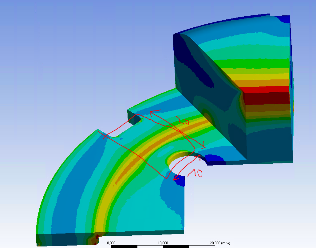

I would like to know the stresses on a defined surface on a plane inside of the body. How can I select a surface like you can see on the picture and put a solution on it?
Is it possible to get an average of the stresses from that surface? If not it would be also helpful to see how many elements of the surface has stresses higher than a defined value.

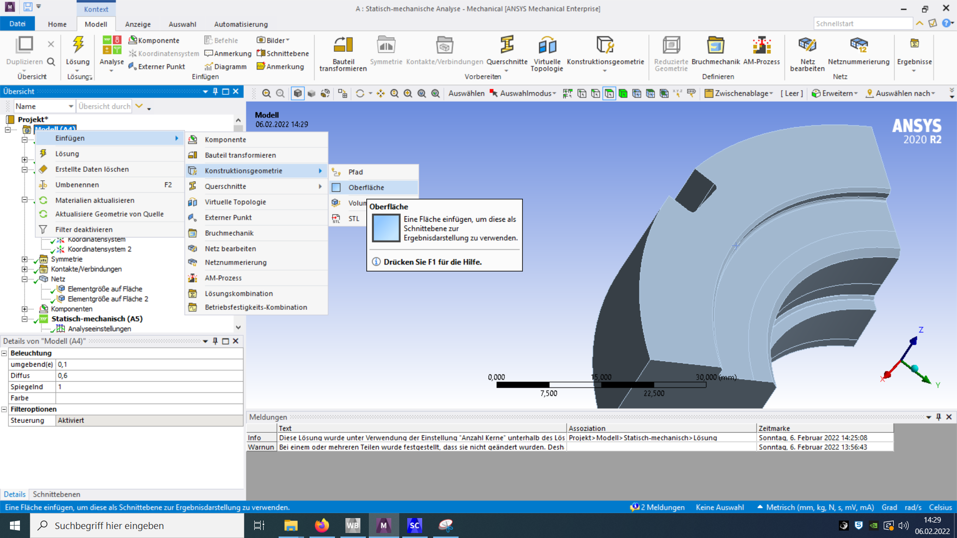

SubscriberYou can Split the bodys in Spaceclaim.
