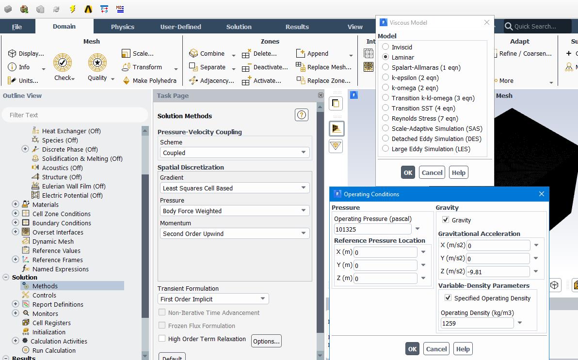

      I am testing a free fall study of an object in Ansys Fluent 2019 R3 and i observed that fluent is not considering the buoyancy force for drag force estimation. I also found a thread in CFD post talking about this and they say the work around is subtracting the buoyancy force from the estimated drag force. Here is the link for the thread. https://www.cfd-online.com/Forums/fluent/105250-buoyancy-6dof-solver-fluent.html.
      Can you guys please confirm if it true that fluent does not consider buoyancy forces during free fall.
      Note that i also changed the operating density to density of fluid.
      Thank you

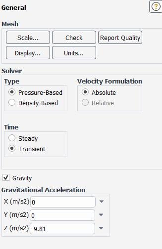

      Thank you for your reply. Yes, i am modeling an object which is falling under the influence of gravity through a fluid (glycerine - density 1259 kg/m3, viscosity-0.779 used default values from fluent database). Here are my setup conditions. Please let me know if you need any more info to check if my model is set up incorrectly.
    • vishwa.kasoju
      Can someone please take a look at my setup and comment. I mentioned my issue with buoyancy force measurement in the top message.

      The set-up looks about right to me. What density model are you using?
      I think you should have the buoyancy forces accounted for in the pressure solution. And your pressure forces should include the buoyancy effects from the fluid.

      I don't understand your question - "what density model are you using?" I am using a pressure-based solver. My theoretical calculations for drag force are not matching the simulation results if we assume the fluent is accounting for buoyancy forces. When i remove the buoyancy forces from drag forces of simulation results i see that theoretical and simulations results to match. This implies that fluent is not considering buoyancy forces right?

      Could someone please suggest a way forward for fluent to account for buoyancy forces? I tried what Kremella suggested still i am getting the drag force on the object equal to its weight which suggests that buoyancy forces are negligible. But with glycerine as fluid medium, we should see substantial buoyancy forces theoretically. Can someone put a light on this? Apart from my fluent settings in the above pictures, the below picture shows what i am simulating.
