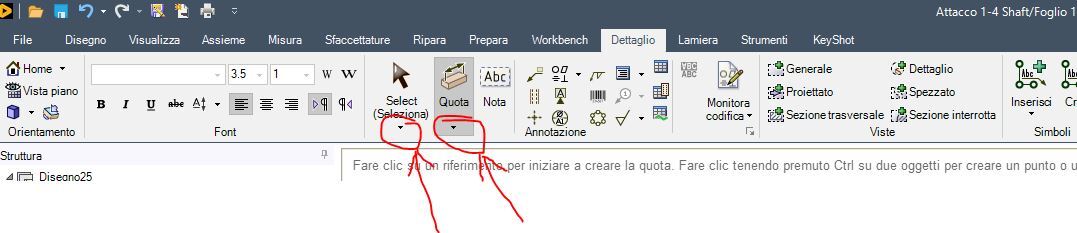

      I found a bug on Spaceclaim 2022 R1 with Italian laguage frontend:
      In the DETAIL ribbon, menu under DIMENSION doesn't work (the pointing down arrow is not clickable so, the menu does not appear).

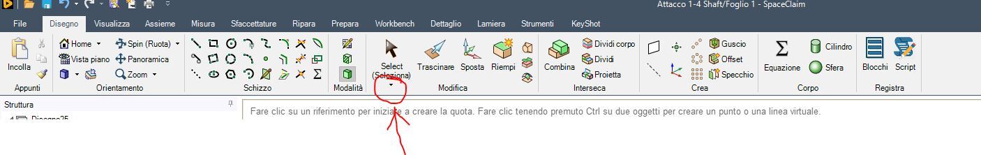

      Same sort for SELECT, both in DETAIL ribbon and DESIGN ribbon.
