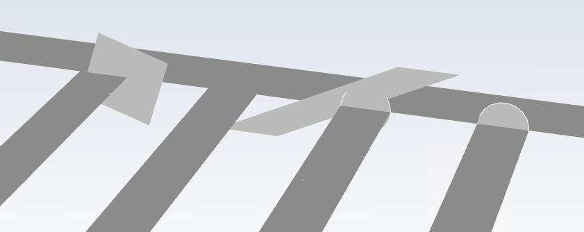

Bounded plane tool using TUI
    • atulsingh92
    • Amine Ben Hadj Ali
      If you go back to the circles created from GUI and try to re-do the same using TUI will it work?
      Work through the whole command and read what Fluent asks for, it may want x1, x2, x3, y1, y2, y3 or x1, y1, z1 or some combination of. Ie type
      /surface/plane-bounded/
      and then follow the prompts
    • atulsingh92
      Thats what I did exactly.
      Becuase there is has to be a manual entry to select where the coordinates should be. It becomes difficult to find a squarish plane that coevers the whole circular periphery.
      Also there are 3 points required in the prompt (x0y0z0, x1y1z1 and x3y3z3) that defines this plane. But how the bounds are to be controlled for the plane, is something that is not clear!
      A plane is defined by three points or a point on a plane and its normal. Again: if you repeat the first working circle with TUI will it work or not?
