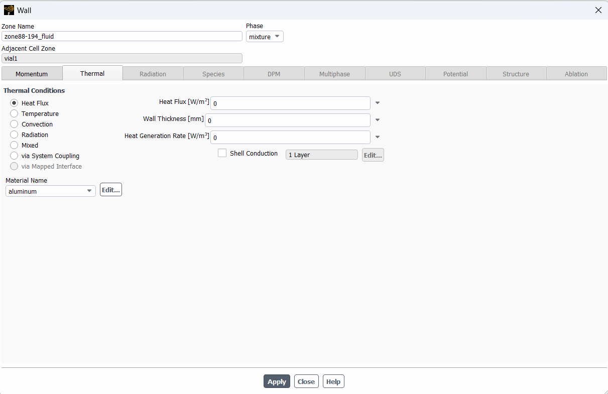

      I have one simulation of a box with a nozzle spraying warm gas on a vial. The second simulation rotates the vial and tracks the water volume inside the vial. I want to capture the influence of the warm gas on the water. How can I implement the temperature of the vial wall as a boundary layer to the second simulation? Can I do this after both simulations have already been ran?
      You can use a profile to mimic the effect, so run one model and pass results to the other. It may not be quite so simple if there's much feedback between the two models.
