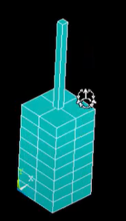

      I am doing a concrete - rebar pullout test, as shown in the figure below.
      I use Combin39 to define the interface.
      In the X and Z directions, I use coupled degrees of freedom for the coincident nodes.
      There are two options to apply the boundary conditions
      1) To fix the Y direction for the front face of the block. In other words, against the pullout direction.
      2) To apply fixed boundary conditions on four sides of the block in x, y and z
      What is the difference in the simulation when a tensile force is applied to the rebar?
      When the four sides of the block are fixed, is there tension in the block when the rebar is pulled?
      Also, I tried to use the first option, but anays says that the degrees of freedom are over-defined. Hence, is the only possible way is option 2 ?
    • Ashish Khemka
      If the four sides are fixed and if you are pulling the bar then the tension should be seen in the model. With force application, you may face a convergence issue.
