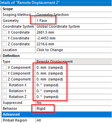

      How to apply boundary conditions to rigid body in static simulation? I also found that there is no mesh in rigid body after finishing meshing.
    • Erik Kostson
      Hi
      That is correct.
      A remote displacement can be defined on a rigid body.
      All the best
      Erik
    • Haiquan
      Thank you very much for your quick response! So if I need the fixed condition for rigid body, what I should do is to scope any face of the rigid body, input 0 for all DOFs, and most important, behavior should be rigid as shown below, is it correct?
