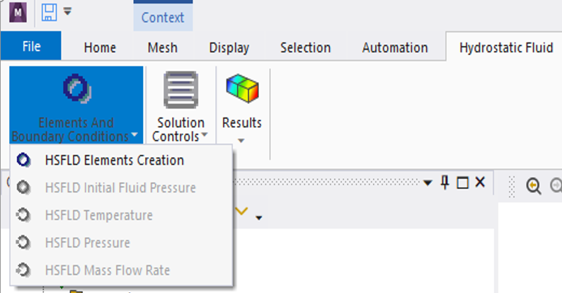

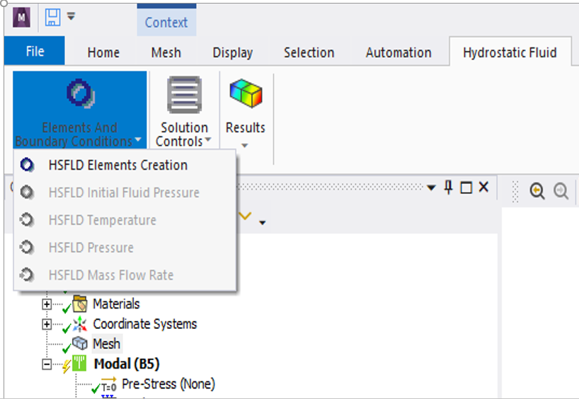

      Hi Please how do I activate the elements and boundary conditions for hydrostatic fluid simulation? Apart from HSFLD element creation, the other boundary conditions are not activated.
      Please i would need your help.
      Thanks

    • i.tamunodienye2
      I want to use modal analysis to find the natural frequency of a complex pipe structure when filled with fluid. So the hydrostatic fluid element HSFLD242 is what i intend to use. If you have another appropriate method to go about this please kindly help me.
      I am using ansys 2020R2.
      I tried to follow these steps ACT_Hydrostatic Fluid Extension.pdf

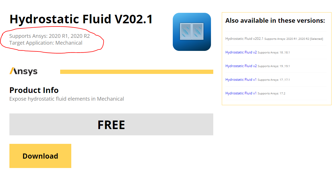

      I got the ACT hydrostatic fluid from the ansys app store Ansys Store Hydrostatic FluidV202.1 created by ANSYS Inc. Though it is V202.1, they stated that the V202.1 can support both 2020R1 and 2020R2. To my disappointment not all the features are activated and i have been on this for several months. Pls how may you help me. I just have few months to submit my work.
      Thanks
    • Erik Kostson
      Hi ´╗┐@Tams´╗┐
      The correct elements to use here to account for the fluid added
      mass exerted by the fluid on the pipe (and other interactions) are the acoustic elements (FLUD220/FLUID221).
      SO you need a modal acoustic analysis with structure and fluid present, and sharing topology (in Spaceclaim or Design modeler) between them.
      See the below discussions on this workflow:
      /forum/index.php?p=/discussion/24433/fsi-problem
      https://www.ijeast.com/papers/323-335,Tesma404,IJEAST.pdf
      https://www.mechsol.com/blog/accurately-predicting-structural-and-acoustic-pipe-resonance
      Erik
      For your info and reference only:
      THe HSFLD elements are for hydrostatic calculation and do not
      provide the correct added mass from the fluid on a vibrating structure so they
      are not used here (modal) and are only for static calculations (like inflatable
      gasket/balloon type of problems, etc.).
