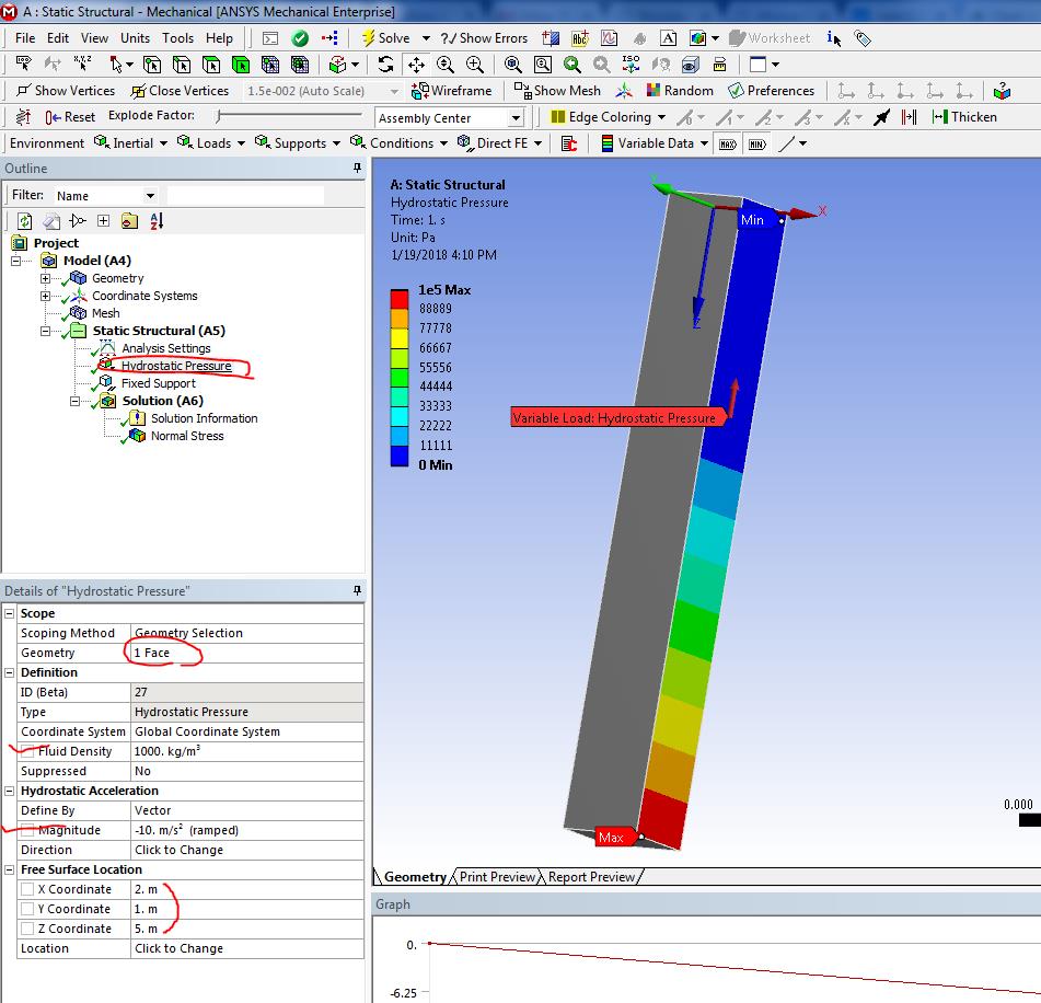

      Hi Rana,
      I am not sure why FSI model is required to solve this problem. If fluid is stationary and your aim to find out the effect of hydrostatic force on the structure then I could go ahead with hydrostatic pressure boundary condition in static structural instead of FSI.
      If this makes sense then test case 42 (VMMCH042) in Workbench verification manual could help you.
