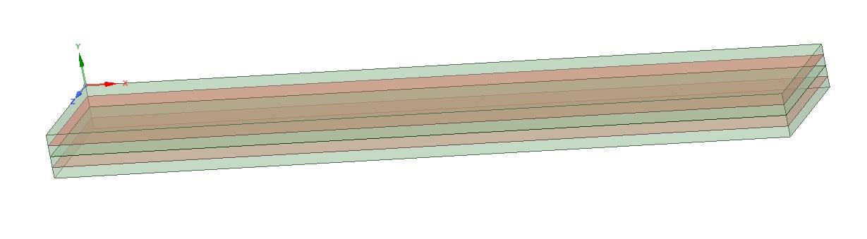

      I am having trouble understanding the results I am getting for a particular problem. I have two identical plates which I want to bond together and subject to bending. To simplify the model, I created mid-surfaces from the solids, and created a 'Bonded Contact' between the resulting shells. The SpaceClaim model I used is shown below. The solid plates are shown in green and their mid-surfaces are shown in red. My understanding is that the two bonded plates should now behave as one plate with twice the thickness. I want ANSYS to take into account the thickness of the shells when creating the contact - the bond takes place in the plane which is mid-way between the two shells.
      The SpaceClaim model of the two plates, which are solids (green), and their mid-surfaces (red)

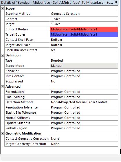

      The 'Contact' settings I used are shown below. I think that I chose the appropriate 'Contact Shell Face' and 'Target Shell Face' (they face each other), and I also set the 'Shell Thickness Effect' as 'Yes'.
      Am I doing something wrong here? Do bonded shells have to be coincident to be modeled properly?

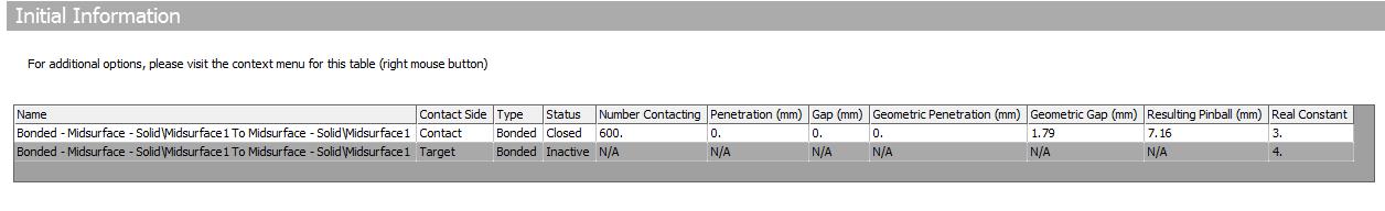

      I checked 'Initial Information' (shown in the image below). The contact status is 'Closed'. The 'Geometric Gap' is 1.79 mm (thickness of the plates, an arbitary number), but the 'Gap' is 0. Interestingly, the 'Gap' is 0 even when 'Shell Thickness Effect' is turned off.
      .'Initial Information' for bonded contact
      For reference, each plate is 1.79 mm thick, 20 mm wide and 120 mm long, made of structural steel. I am simply supporting both ends and applying 100kPa of pressure on top. Deflection in the middle should be 0.353 mm, but its 1.42 mm.

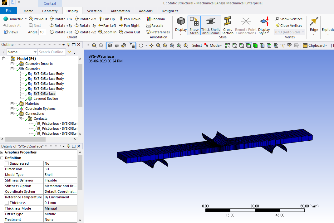

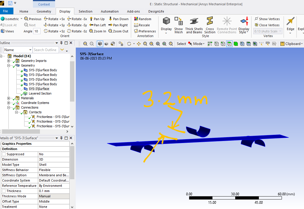

      I am facing a similar problem in 3- point bending test using layered section having thickness 3.2 mm as mentioned in image.(I have to fill this gap with layered section).
      To make connection among layered section and upper roller, target or contact require surface or face on the layered section but, I'm unable to do so.
      So, could you please tell me how to make connection between layered section and roller face.
      Also kindly suggest me which connection should I make in these rollers in order to conduct 3 point flexural test ASTM D790.  Because I'm doing this first time.
