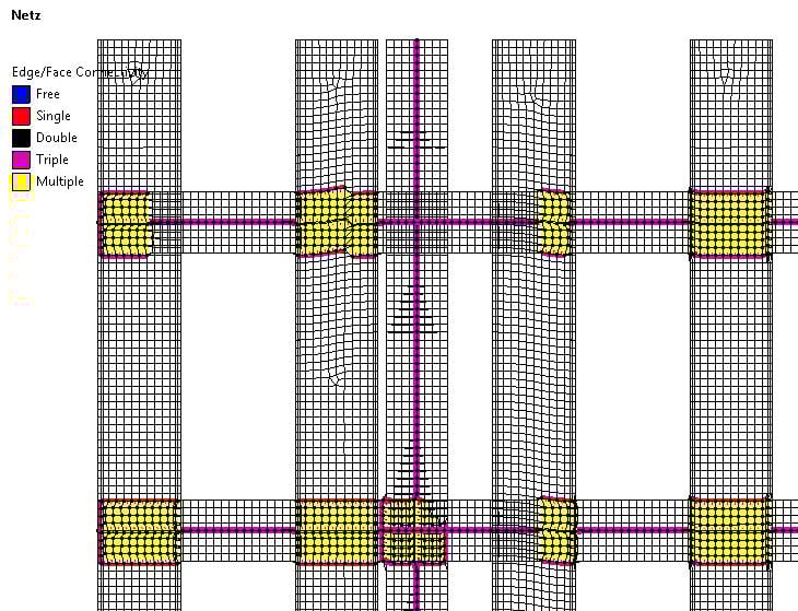

Are you using SpaceClaim? If so, Can you use the 'Show Contact' tool to look and make sure that the edges are being shared? Make sure to change Share Topology to 'Share' in the properties window.
Even in mechanical, you can check this by turning on 'Edge Coloring' > 'By Connection'. This will allow you to see if the edges are being shared between components.

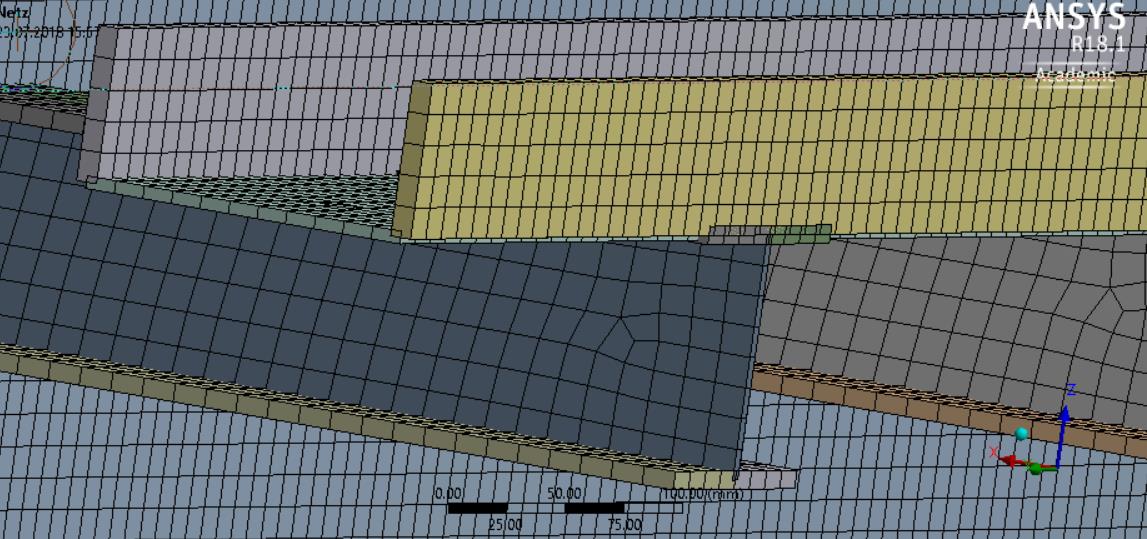

One way to connect those profiles is to use an Automatic Node Merge. I used a 7 mm Tolerance Value and turned on Face/Face.
This is the result:
Note that one of the profiles didn't get any nodes merged at the 7 mm setting, and some of the elements are getting distorted during the merge.
A much better way is to create a Named Selection of all the faces of the U-channels on the top and second Named Selection of all the faces of the I-beams that they rest on and make a Contact Definition between two Named Selections. When I did that, I found that some face normals are not in the same direction as their neighbors, so that needs to be accommodated to use this method.

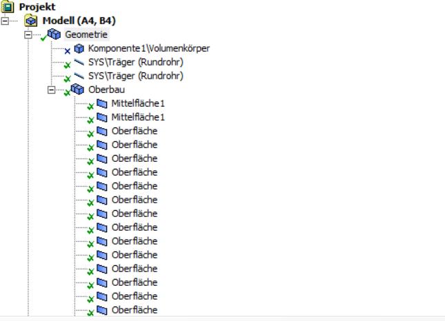

I suppressed your line bodies. I suppressed Fixierte Lagerung. I changed your springs from Body-Body to Body-Ground, I suppressed Körperwechselwirkung (Body Interactions) since you don't want extra complexity during the first attempt to solve.

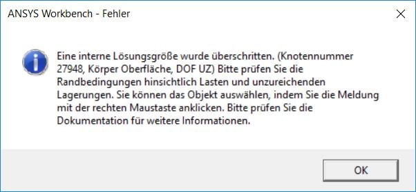

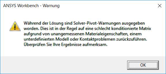

@Sandeep: The model fails quite in the last part of solving. Nevertheless the force convergence shows no entry.
@Peter: I've now created those two named selections and made a contact definition between them. Furthermore I suppressed the same as you did. Unfortunately I still get the same error message. I've also created a third named selection for the lower I-profiles and connected them to the middle H-profiles, which didn't make any difference.Â

In DesignModeler, I picked all the bodies in Oberbau and set the Shared Topology Method to Automatic.

I changed your groups to have 11 faces in UPE and 14 faces in HEA, the faces that touch each other, not the faces away from that plane.
I changed your IPE to have 4 faces and created HEA2IPE with the 14 faces on the other flange of the I-beam.
I updated the two contacts to use these two pairs of named selections and set them to use MPC contact, which is easy to visualize in the results, set the shell sides, and set a manual pinball radius. I don't know if those settings were necessary.
I added a contact tool to show that the contacts were were closed.

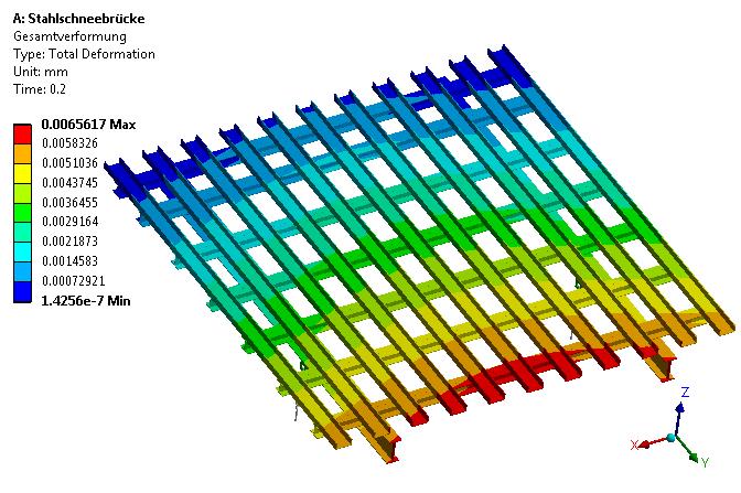

Now the Static Structural model solves (at least to 20% of the full load).
Attached is an ANSYS 18.1 archive.
