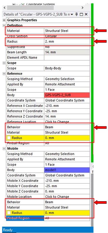

      Dear sir
      Sorry if I was not clear. Please allow me to clarify.
      As you can see in the screenshot, for the Reference body, when I set the "Behavior" to "Beam", a new "Material" and "Radius" appear. The same thing occurs for the "Mobile" body. So I end up with 3 materials and 3 radii.
      So my questions are as follows:
      1) What is the difference between the three materials and radii? Or this is a bug in Ansys?
      When you have a Beam Connection, a beam element is created from an end point on one side at the center of the selected geometry, to an end point on the other side. This is like the shaft of an actual bolt where you can specify the radius and material.
      ANSYS gives you the option to run beam elements from the end point of the bolt shaft to the nodes on the surrounding geometry. It is not a bug, but I don't use that feature. I use Rigid or Deformable for Behavior to get RBE3 or RBE2 type MPC connection equations from those end points out to the nodes on the selected geometry (face or edge).

      Here is a tutorial showing a Solid Body representation of a bolted joint. This is the most detailed and accurate method of representing a nut and bolt connection, but it is also the most time consuming to build and solve.
      A simpler representation is to delete the Nut and Head and just keep the shank of the bolt, but represent the shank with beam elements.
      In older releases of ANSYS, you had to go back to CAD and draw a line at the center of the bolt so there was a line body to mesh with beam elements.
      BEAM CONNECTION
      In newer releases of ANSYS, they have automated away the task of drawing the line body. Now it is as simple as choosing Beam Connection, and picking an edge or face for the head end and an edge or face for the nut end of the bolt shank.
       WELDED SEAM
      A common modeling situation is to have two thin plates come together and be welded. A simple representation is a midsurface shell model. In older releases of ANSYS, you could use Bonded Contact and set the Behavior to MPC so you could see the connection elements of the Bonded Contact. This works great for transferring a load from one end of a part to the other, but if it is a long weld seam, you don't get a local measure of the force going through each connection element.
      In a newer release of ANSYS, they added the ability to replace the MPC connection elements with Beam elements. Now you can extract the axial and shear force from each individual beam element along the weld seam. This makes evaluation of weld strength much easier.
      The user interface for Bonded Contact got a new capability to select a behavior of Beams instead of an MPC type of connection.
      MULTIPURPOSE CODE
      Back to the Beam Connection capability, the default behavior is the MPC end condition of Rigid. It never occurs to me to change the behavior to Beam. Just like the Swiss knife, while I'm using the scissors, I don't pull out the bottle opener, it would only be in the way.
      You might suggest that the developers hide the ability to set the behavior to Beams when doing a Beam Connection. In the meantime, you can just ignore that capability.

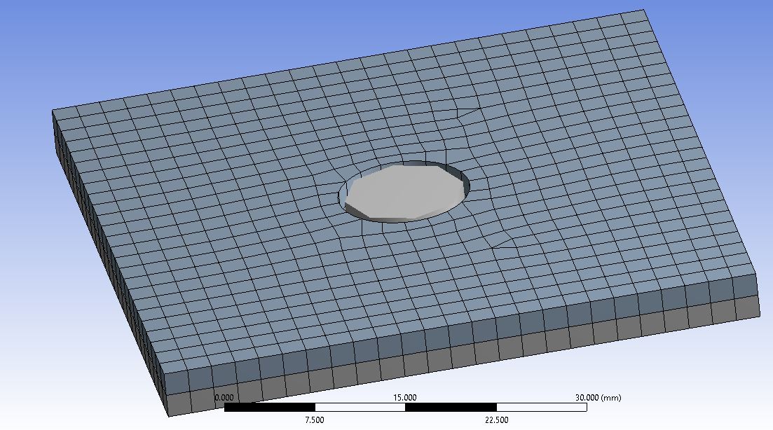

    • George_Aerospace
      Dear peteroznewman
      I thought I can model the bolt accurately and efficiently using Ansys beam connection. To do so, instead of the 3D model in your video tutorial, it is enough to just:
      1) Spider MPC from the upper-hole-edge-center to all nodes within a circle offset from upper hole edge, to have the diameter of the bolt head
      2) similar spider MPC from the upper-hole-edge-center to all nodes within a circle offset from lower hole edge, to have the diameter of the bolt head
      3) 1-D beam element connecting the centers of the above two spider elements
      This is what exactly done using NX "Bolted connection".
      I wished Ansys can do the same using Ansys beam connection. I thought that the "Radius" or "Pinball region" properties can do the same as NX bolted connection. To confirm this, I have created the shown test problem. I tested all the behaviors of the beam connections ("Beam", "Rigid" and "Deformable"). To be sure, I exported the fem model from "Mechanical" to an ANSYS input file and opened it and confirmed that Ansys just creates a spider element and connects it only to nodes on the edge nodes. That is, Ansys beam connection cannot model the bolt nut nor head using any of the "Radius" or "Pinball region" properties. I began to believe these properties are buggy and has no effect at all.

      Dear George,
      You've got it wrong.
      I understand the NX way of doing bolt connections. In fact, I have a video on that topic that I just uploaded to my YouTube channel, but this is not an appropriate place to show NX videos!  I understand it's frustrating when ANSYS does things differently to NX.
      You don't understand what Pinball does. To have the effect you want, you must pick the face, not the edge. I demonstrate this in a followup video to my original solid body fastener tutorial.
      The default Behavior when a Beam Connection is made is Rigid. Why do you insist on changing it to Beam? That is not useful. Stop doing that. If you want, you can put in an enhancement request to ANSYS that when a Beam Connection is being defined, the Behavior list is only the two MPC types of Rigid and Deformable. I would support that.
      I'm not ANSYS staff, but they do read these posts and maybe one of them can submit this as an enhancement request for you. Over the years, I have submitted a few enhancement requests to ANSYS through my ANSYS Elite Partner, Simutech Group, and one of them was implemented!
