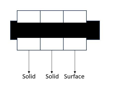

      I want to connect to 3 parts which are 2 solids and 1 surface using fixed joint. What should I do? How can I connect them with fixed joint method? Actually, I do not want to use solid or beam modeling.
      A Fixed Joint has two sides: Mobile and Reference.  Click the circular edge of the hole in the surface when selecting the Reference side. Click the two cylindrical faces of the holes in the solids when selecting the Mobile side. The joint will hold all three parts together.
