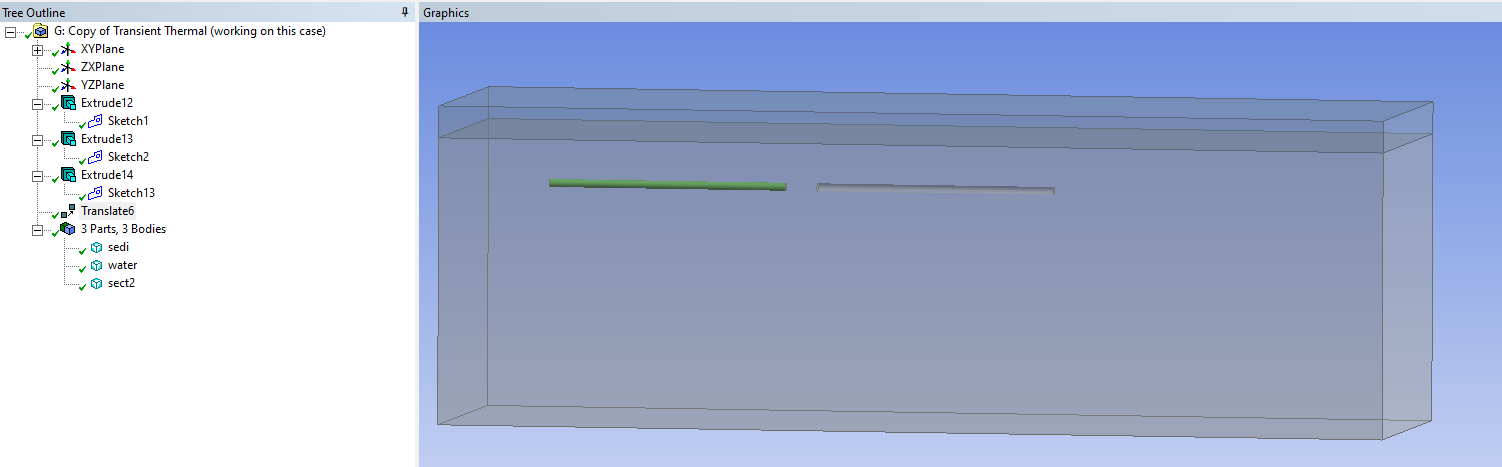

      Hello Ansys community,
      I am creating a 3D model in DesignModeler. The model comprises a cuboid (tank) with a thin cylinder (heat source) inside the cuboid. First, I drew the shorter face of the cuboid and extruded it. Then, I drew a circle inside the rectangle and extruded it to create the thin cylinder (I selected "Slice material" on the operation tap). Since the cylinder needs to be 1 m from the centre of the cuboid, I used the "Translate" option to move the cylinder in the Z direction. I am attaching an image of the model for clarification.
      In Mechanical, I created the mesh, assigned BC, and heat flux to the cylinder. When I run the simulation, there is not heat transfer from the cylinder to cuboid. However, if I leave the cylinder in the centre of the cuboid (no translation) heat transfer works ok.
      Could you please guide me on the correct way to build the thin cylinder inside the cuboid? Thanks in advance.

      What you have to be sure to have is an interface between the cylinder and the cuboid. In the computer these can occupy the same volume, but physically they cannot. My approach would be as follows:
      1. Draw the rectangle and create the cubes.
      2. Draw cirlce (or rectangle if you want to use revolve) and create the cylinders.
      3. Use a Boolean operation to cut the cylinder from the cuboid.
      4. (if you want a congruent mesh) Put them in a multibody part.
      Using the above approach, Mechanical should pick up the contact between the bodies. If not you can create the contacts manually.

      I reckon that using Extrude or Boolean operations can both do the cut and create the interfaces (using the "slide" option in extrude and "substract" in boolean). The problem is when I want to move the cylinder to the desired position inside the cuboid. Yesterday, I created a new plane at the position where the cylinder should be located and it worked. However, if I need to include more cylinders in other positions, I may need to add as many planes as cylinders are required. So the task will become quite repetitive.
      Wonder if there is another way to add sub-bodies in specificic positions (not at the centre of the XY plane) inside a main body?
      Laure, if the cylinders are in a rectangular or circular pattern, then Create > Pattern can take one cylinder and make as many copies as there are in the pattern.  As NickFL said, use a Boolean to subtract the pattern from the tank and finish up selecting all the bodies and Form New Part.
