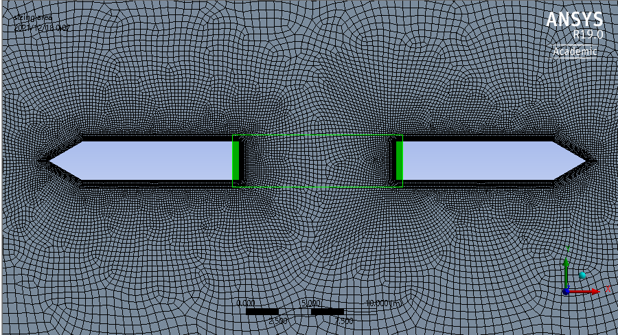

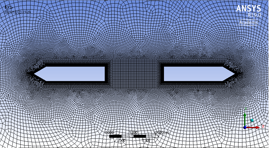

I used "body of influence" for meshing between two boxes more finely.
I selected one body around 2box as target geometry, and the area of between 2box is selected as body of influence.
But it seems to not work like follow pictures. How can I do this ?

Ansys EmployeeHello Are you looking to refine the mesh in the box region?
December 23, 2021 at 2:50 pmDecember 23, 2021 at 3:32 pmRahul Kumar
Ansys EmployeeYou could redefine the BOI geometry to enclose both the hollow geometries.
