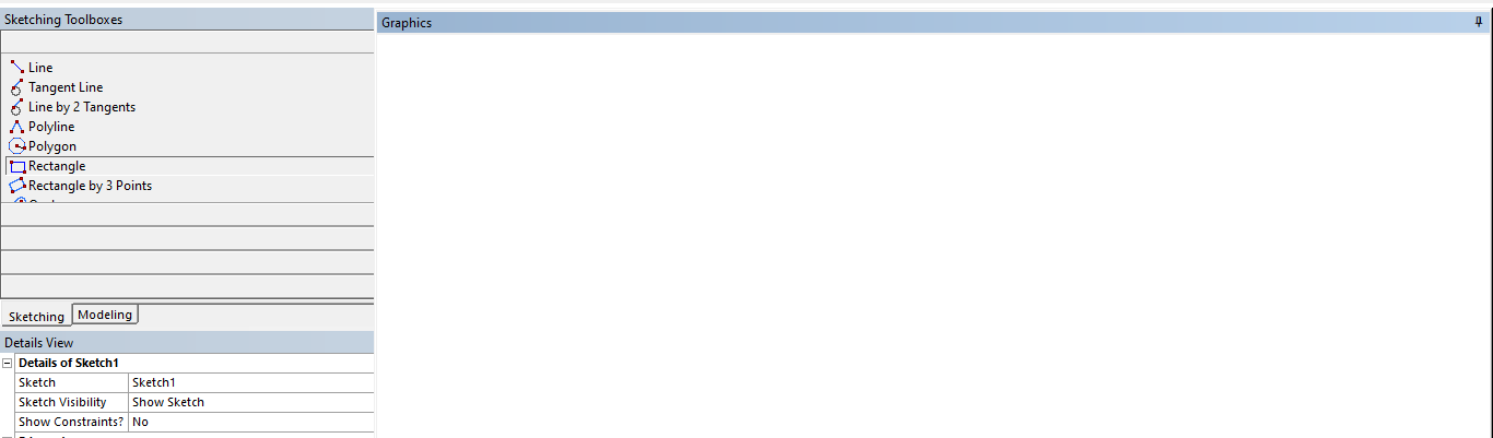

December 30, 2021 at 8:33 am
IITTP
SubscriberIn the design modeler, the graphic is not visible. The graphic section is completely blank and also sketching toolboxes are not visible.
December 30, 2021 at 11:13 amAkshay Maniyar
Can you check the thread /forum/discussion/28037/designmodeler-displaying-graphics-as-blank-white-screen and see if it helps.
Thanks Amaniyar
December 30, 2021 at 11:19 amIITTP
SubscriberI tried but it is not working. I cleaned app data then also issue not got resolved. Please suggest some other solution.
December 30, 2021 at 11:43 amSaumadeep Choudhury
Please take care of the following 2 points:
Make sure you have a valid license.
Use Recommended hardware (Mentioned below)
Minimum hardware requirements (Download Ansys Student | Workbench-based Simulation Tools)-
Processor(s): Workstation class
4 GB RAM
25 GB hard drive space
The computer must have a physical C:/ÔÇØ drive present
Graphics card and driver: Professional workstation-class 3-D
OpenGL-capable
Regards, Saumadeep
Ansys Help
Ansys Learning Forum (Rules & Guidelines)
December 30, 2021 at 11:51 amIITTP
SubscriberI checked the requirements. I have all the mentioned specifications.
December 30, 2021 at 12:17 pmSaumadeep Choudhury
Forum ModeratorTry resetting the layout. refer this - How to restore View in Design Modeller ÔÇö Ansys Learning Forum
Note- The "Reset Layout" is not available when the BladeEditor toolbar is active. User can disable BladeEditor from DM > Tools > Addins if he does not want to use it.
If that doesn't work, try re-installing with a valid license.
December 30, 2021 at 12:48 pmIITTP
SubscriberI tried that also but it is not working. I also reinstalled with license then also not working.
December 30, 2021 at 2:28 pmAkshay Maniyar
Can you open mechanical and spaceclaim? Are you getting issue with DM only?
Can you check if you are getting any warning or error when you are opening DM and share that warning. So that it will be easy to find the issue.
Also, try updating your graphics card driver.
Thanks amaniyar
December 30, 2021 at 2:35 pmIITTP
SubscriberI am getting issue only with DM. No warnings are coming.
January 1, 2022 at 3:39 amIITTP
SubscriberPlease give any solution.
