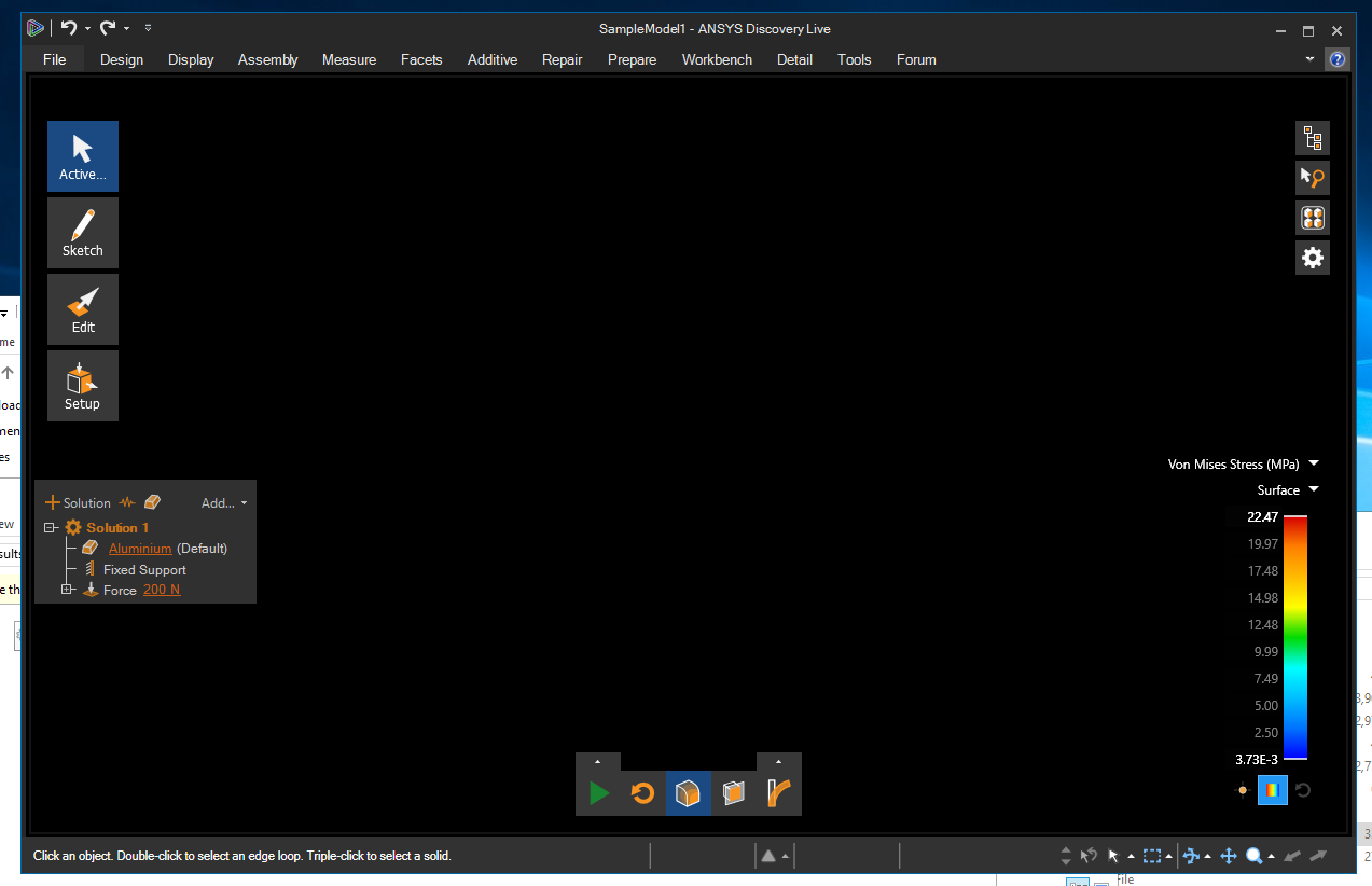

      Hello!
      Discovery R3 Live now have absolutely black and unchangeable background. All projects and samples work fine (panels are active and the color legend changes after solving) but nothing can be seeing and done as well.
      Could you please help to find out what is going on?
      (R2 and previous versions don't have this effect. nvcuda.dll  does not exist in the directory)

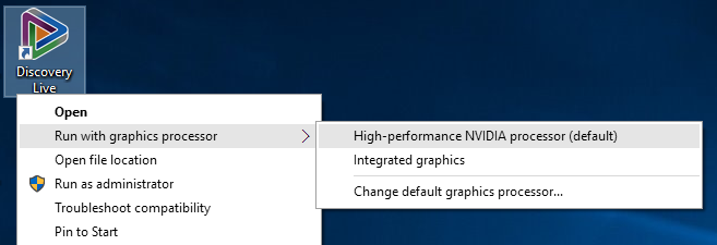

      Could you check if Discovery Live is running on the intended GPU and not the default GPU on your machine?
      For this, right-click on Discovery Live icon on the desktop and select "Run with graphics processor" and select High-performance NVIDIA processor. See below image.

      • user deleted
        Thank you Naresh Patre
        I don't have this "Run with graphic processor" option but turning off all but main graphic card helped.
        Now everything works for some reason.
