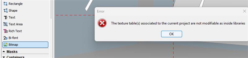

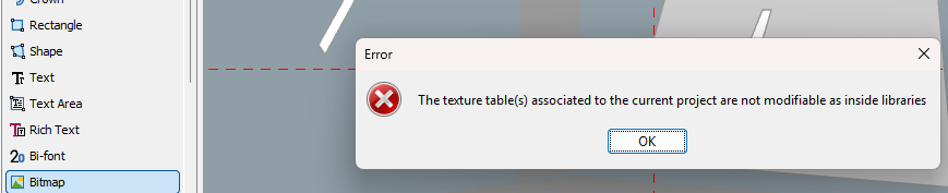

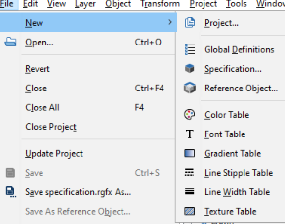

To avoid this error go to your, first you'll need to create a texture table in your project (File -> New -> Texture Table)

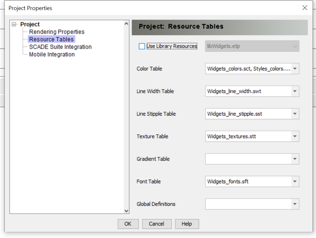

Then, you'll need to set it up in the Project Properties
 Project Properties -> Resource Tables and un check 'Use Library Ressources'
Then make sure you have selected the texture table you have previously created.
This should solve your issue.
