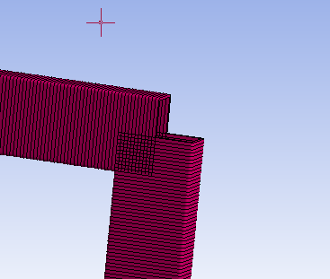

SubscriberHello everyone, the beams are connected by centroids, in the center. How to connect them correctly in workbench? To make the connection believable.

Ansys Mechanical by default creates beam connections at the centroid. To change the Offset Type Connection from Centroid, do the following:
Select the beam under Geometry in Tree Outline. In the Details View, change the Offset Type from Centroid accordingly.
