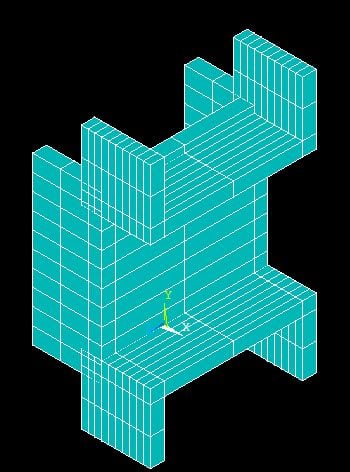

      I'm currently trying to model this beam shown below in ANSYS APDL. I'm very new to the software so I'm still trying to get the hang of it and I need to learn it for my undergraduate studies.
      But the problem is, whenever I do try to model it on APDL, the structure looks like this:
      Is there any way to orient it similar to the intended structure in the first image? Any help would be appreciated.

      The code that I generated looks something like this, just for reference. Any help would be greatly appreciated.
      /PREP7 ! Enter preprocessing phase
      ! Define keypoints
      K, 1, 0.05, 0, 0
      K, 2, 0, 0, 0
      K, 3, 0.15, 0.06, 0 ! This keypoint is where the force, P, is
      K, 4, 0, 0.12, 0
      K, 5, 0.05, 0.12, 0
      ! Define lines
      L, 1, 2
      L, 2, 4
      L, 4, 5
      ! Define elements
      ET, 1, BEAM189
      ! Define cross-section
      SECTYPE, 1, BEAM, CHAN
      SECDATA, 0.05, 0.05, 0.12, 0.01, 0.01, 0.01
      SECPLOT, 1 ! Plots the current cross-section
      ! Define material properties
      MP, EX, 1, 200e9 ! Elastic modulus in Pa
      MP, PRXY, 1, 0.3 ! Poisson's Ratio
      ! Mesh the beam
      LESIZE, ALL, , ,10, 1, 1 ! specify divisions on unmeshed lines
      LMESH, ALL ! Mesh all lines
      FINISH ! Finish preprocessor phase
      The way it works is you have just one line between two points, a distance L apart.
      The cross section is applied to that one line.
    • cloudstrife12
      Thank you, I will give it a try. I also wanted to ask, when applying constraints, since at one end of the channel it is a fixed support, do I then just apply it to those two points you've mentioned? Much appreciated
      You apply the fixed support to one vertex.
