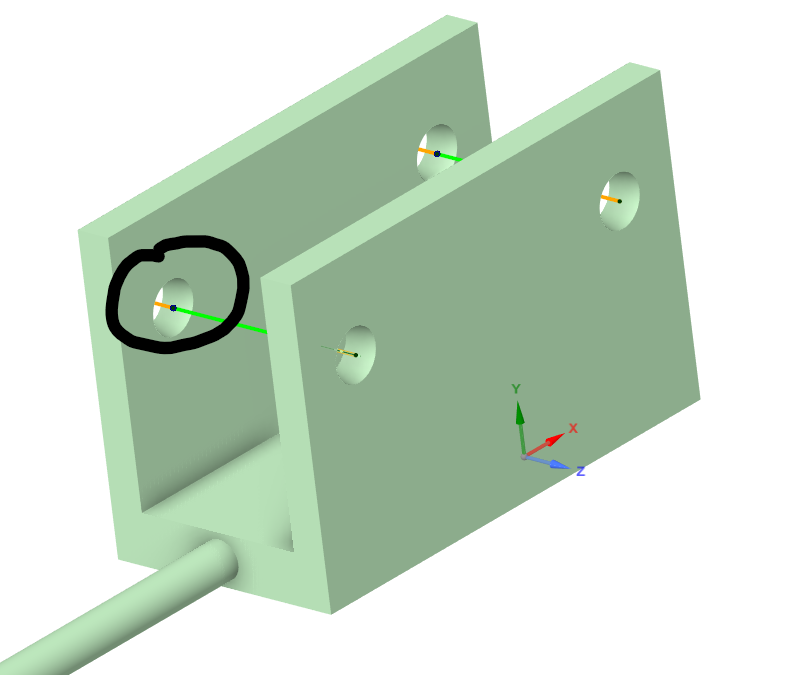

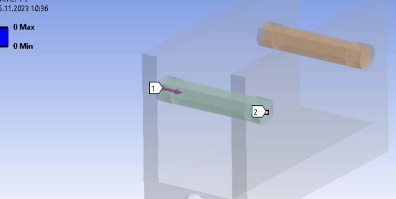

      I want to create beam to use it in static structural analysis, however it is created 3 edges. I tried to share, but it is not done well. I used point to create beam, because I will connect point-solid edge with joint connection.
      Can you help me, please? Is there any video to learn?
      I can't see any stress for beams
