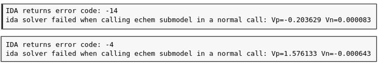

Ansys EmployeeHi Nitesh, HPPC data fit is very important for Fluent to run the model with out any issues. This issue occurs mainly if the HPPC data (Voltage vs time) is not similar for all SOC levels. Please plot Voltage vs Time to confirm this. If this is the issue, you have to check your HPPC data again.
August 9, 2023 at 7:12 pm
Nitesh Gupta
SubscriberHey Murari,
Would you please elaborate? This does not make any sense w.r.t my problem.
I am doing 1C,2C,3C... discharge for NMC-Gr Li-ion cell. I have voltage-time plots at the mentioned C-rates, but they all show the same error near the end of discharge.
