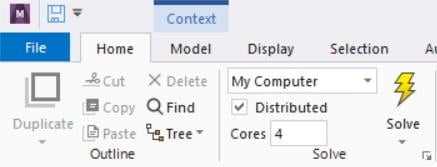

Here are old instructions for setting the number of cores and turning on Distributed ANSYS in Mechanical.
In the new user interface of 2019 R2, it is simpler. They are right on the ribbon.
If you use the settings above, there is almost never a need to use the DSPOPTION in Mechanical.
Distributed solves are almost always faster than Shared Memory solves, so you won't need BCSOPTION.
The only time I have used DSPOPTION is to force the solver to run in-core when its own logic chose out-of-core, but I knew it would fit in-core.
