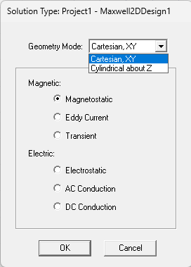

Is there any opportunity to make a cylindrical (rotational) axisymmetry simulation in Maxwell where the axis of symmetry is x (not z)?
I tried to make a model that uses both Fluent and Maxwell through system coupling, but the problem is that Fluent uses x-axis as the axis of symmetry, while Maxwell uses z-axis for symmetry.

Ansys EmployeeYes, you can change that in Motion Setup. Type tab->Moving vector: select the rotating axis
