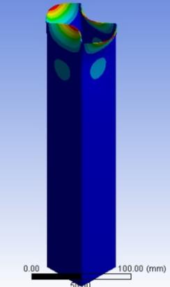

    • vineesh karthikeyan
      Thank you sir. im expecting a global buckling failure similar to the second picture. The result i get is shown in picture
      How did you constrain the top of the column?
      Did you introduce any imperfections into the geometry to induce the buckling?
      Sir, support conditions i provided are free at top and fixed at bottom and length of the specimen is half of original length so that it is equivalent to pined at both ends according to Euler's buckling load theory. The geometrical imperfections is corresponding the the lowest energy mode ( here it is mode1) from the eigen value buckling analysis. The above result is mode1 from linear analysis. Actually im doing a non linear analysis for this specimen but im not getting an expected buckling shape ( i.e buckling at the middle hieght ). so, i cant proceed to non-linear analysis.

      You can simulate half the original length, but there is a Symmetry BC that you have to apply to do that correctly. Leaving the edges free is incorrect. You can use the Symmety feature in DesignModeler to create those Symmetry BCs automatically for you, or you can manually add them. For a shell model, assuming the column axis is along the Y axis, add two Supports: a Displacement, Y=0 and Rotation, Rx=0 and Rz=0.
      Fixing the bottom edge is not simulating a pinned end, it is simulating a fixed end. To simulate a pinned end, use a Remote Displacement on those bottom edges. Set the behavior to Rigid. Set X,Y,Z to zero and set Ry = 0.  Leaving Rx and Rz free creates the pinned end.
      Yes, you cannot perform a linear buckling analysis with Large Deflection on. But with that on, you can perform a Static Structural analysis and track the force displacement curve to the point of zero slope, which is the nonlinear critical buckling load.

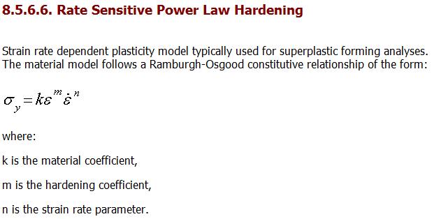

      Sir, the material model i need to use for the analysis is based on two stage Ramberg-Osgood equation. The stress-strain equation is based on 2 stage Ramberg-osgood equation. So, how can i modify the stress-strain curve in the Engineering data to 2stage Ramberg-Osgood equation? Also I need to incorporate two parameters proof stress (e) and strain-hardening exponent (n) into the engineering data.
      Explicit Dynamics supports this material:
      Is this what you mean?  Materials with a strain-rate parameter will exhibit that behavior in a dynamic analysis. You are performing a static analysis of a nonlinear buckling model, so the strain rate would be zero. Is that correct?
      For Static Structural models, I have used a plasticity model that has kinematic hardening. Either Bilinear or Multilinear.
      Or there is this...
      Go to the Online Help (if you are on 18.2) and read the Mechanical APDL, Material Reference.
