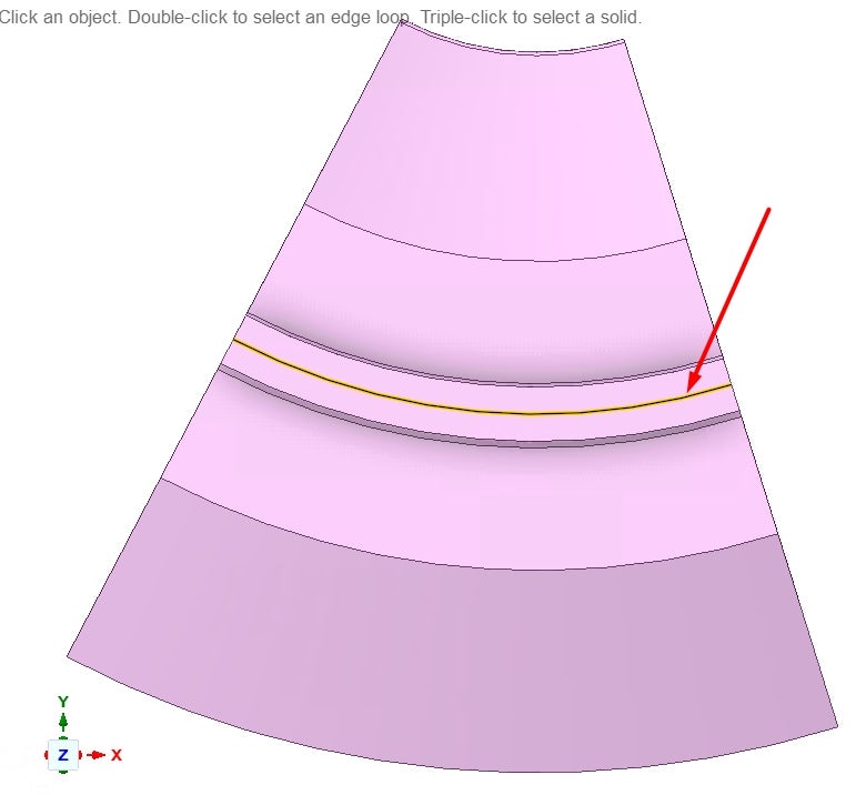

you can calculate the average temperature along a line or at a specific location using the Report Definitions. select Reports > Surface Integrals
For more details you can check user's guide: 40.7. Surface Integration (ansys.com)
