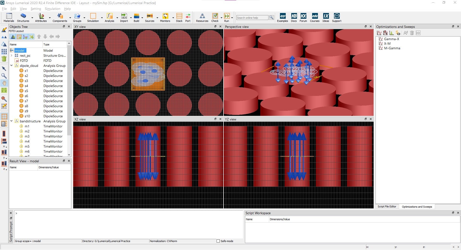

      I'm trying to perform a 2D FDTD simulation with my own defined material in order to find band structures of a Photonic Crystal. This is how main simulation looks:

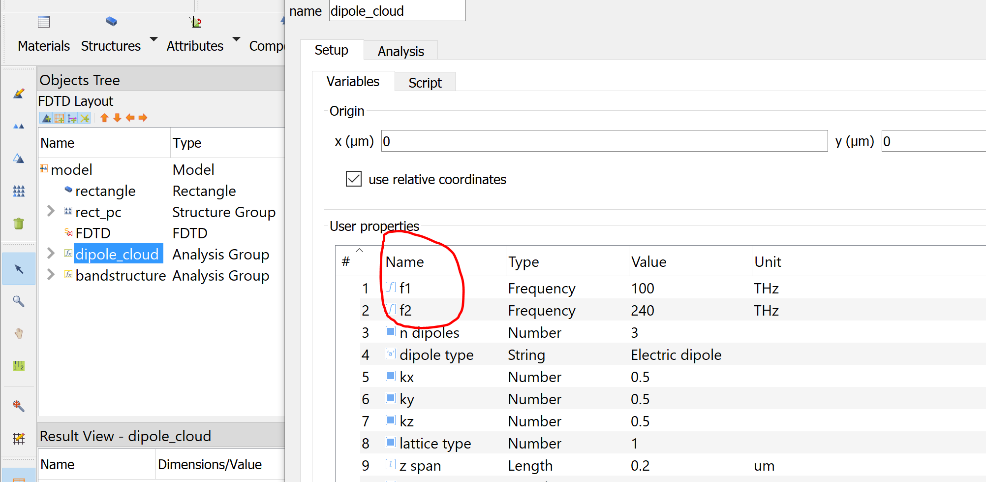

      What is the actual simulation bandwidth in the dipole clod?

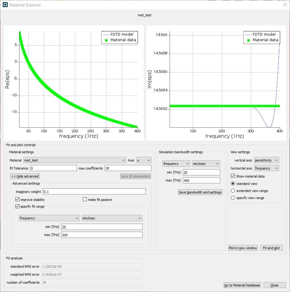

      Hello dear gsun Thanks for your reply. As you mentioned, I lowered imaginary weight and therefore here are new plots:

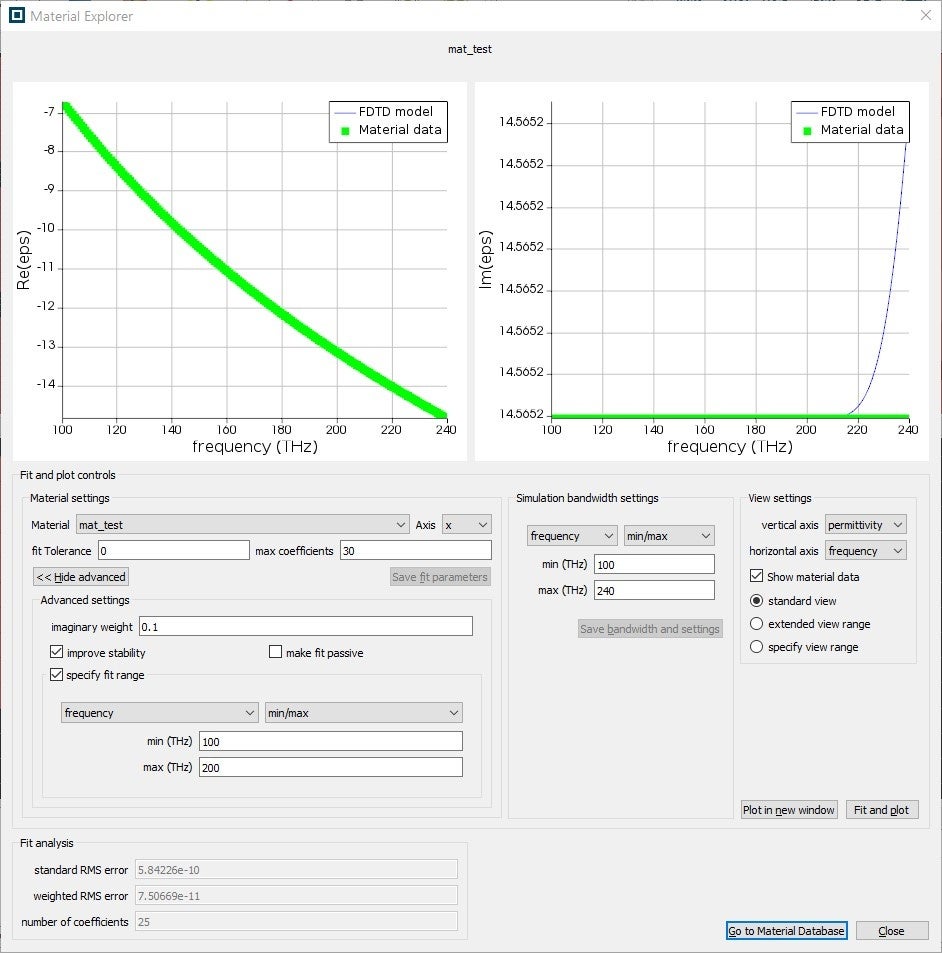

      Also simulation bandwidth in dipole cloud is set as a parameter in model script. Which in my case it is same as shown in material fitting window. To be exact, f1 = 20 (THz) and f2 = 400 (THz). However I tried your suggested range and the issue still remains. I changed fit range to make it as fit as possible. Here is the result for you to see:
