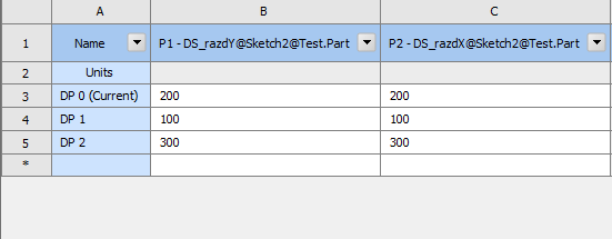

      I am currently working on a project in Ansys Student 2023, where I would need to make many iterations based on location of a certain part (let's say a couple of thousand different locations). The model was drawn in SolidWorks and the x and y parameters for location were also imported and parameterized. Now I need to do a Modal analysis and Harmonic analysis.
      Figure 1: Imported parameters (currently only 3 for testing purposes).

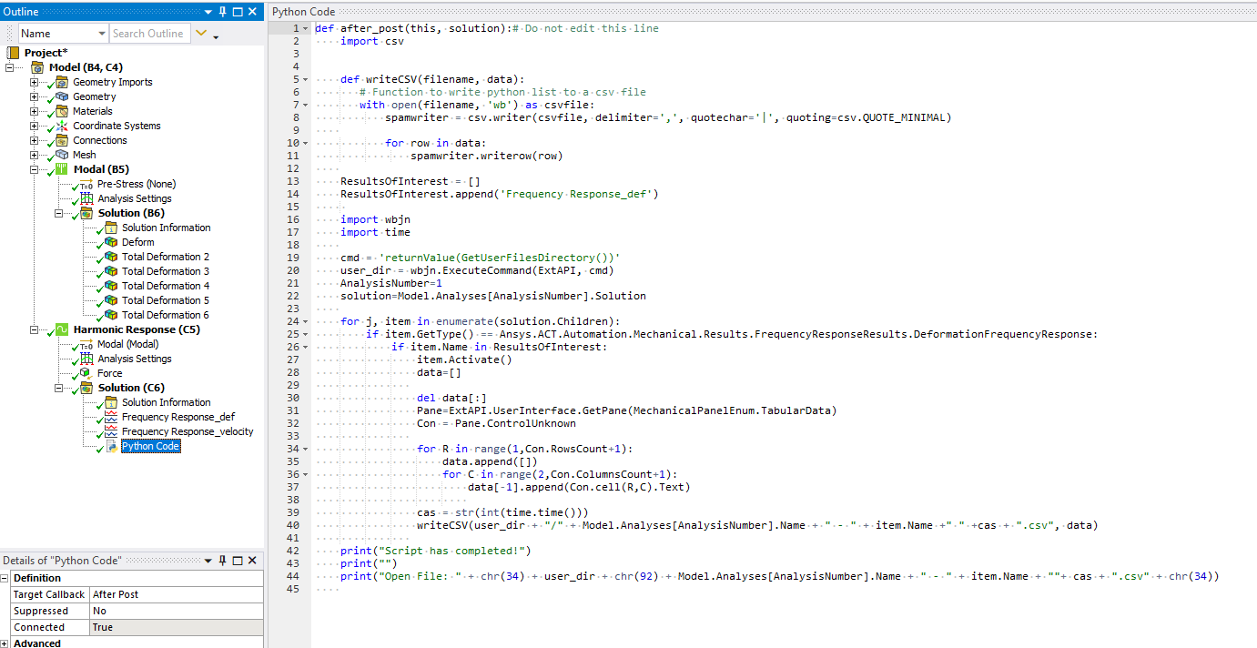

      From harmonic analysis I would like to export a CSV (or similar) for the tabular data of Frequency response deformation for each design point. Currently I have spent the whole weekend trying to find a solution.
      Figure 2: Tabular data I would like to export
      I found this (Figure 3) and it seems to work, BUT! It only works in Mechanical. If I update all design points it doesn't generate the files:
      https://blog.ozeninc.com/resources/using-python-to-export-tabular-data-from-within-ansys-mechanical
      The reason is that this method only works with the Mechanical GUI:
      /forum/forums/topic/tabular-data-extraction/
      Figure 3: The Python script, slightly modified to work.
      Now is there any way of doing this with Python? Or any other way of doing this? I have found APDL and VWRITE, but have no clue in this regard.

    • ErKo
      Hi
      By default, the Python objects are not connected, for security purposes. It is possible to activate an option to automatically connect the Python objects. This is mandatory to be able to use Python objects in a Design Point experiment.
      The option is: activate the Connect/Run Python Code Objects when Mechanical is Launched preference contained in the Mechanical category of the Workbench Options dialog (Tools > Options > Mechanical):
      See this page of the help for further information: https://ansysproducthelpqa.win.ansys.com/account/secured?returnurl=/Views/Secured/corp/v231/en/wb_sim/ds_python_code.html

    • Maks Brus
      Thank you for your answer Erik!
      But it doesn't solve the problem as I had the option enabled before posting the question. The script runs, but it doesn't work because it requires Mechanical GUI, which doesn't open if you update all design points from Workbench.
      • Akshay Panchwagh
        I am facing the EXACT issue. I need to store the results for the Parameter Set in a CSV file, and I have used the script from the same source (Ozen Engineering). Even I have enabled the option to connect Python Code Objects when Mechanical is launched. Still no success. Were you able to figure this out?

        • Akshay Panchwagh
          Greetings Maks!
          I finally found a solution which is working according to my, or our liking. I am able to export the results in Tablular Data for all the selected Solution Objects while the Design Points update through Workbench. I used a different script which does not need to access the User Interface Pane command to read the results. From what I understood, the UserInterface.GetPane command needs the Mechanical GUI to be open in order to work. So I found a workaround after interacting with ANSYS employees regarding this problem. You also don't need to make any changes in the Property Provider in order to get the active Design Point number. Initially while executing this script, Workbench used to crash. So I updated it from 2022 R2 to 2023 R2. And now it works perfectly.
          I am posting the script here. Let me know if it works for you. I will suggest to use the latest version of Workbench for this script to work. Otherwise it will crash.
          Also, the main parts of the code which I thought were necessary for successful execution of the script have been highlighted in bold. Rest of the parts you can edit according to your needs.
